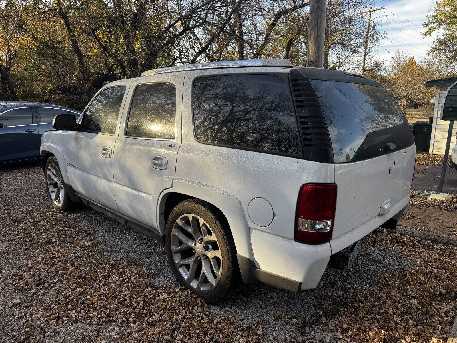

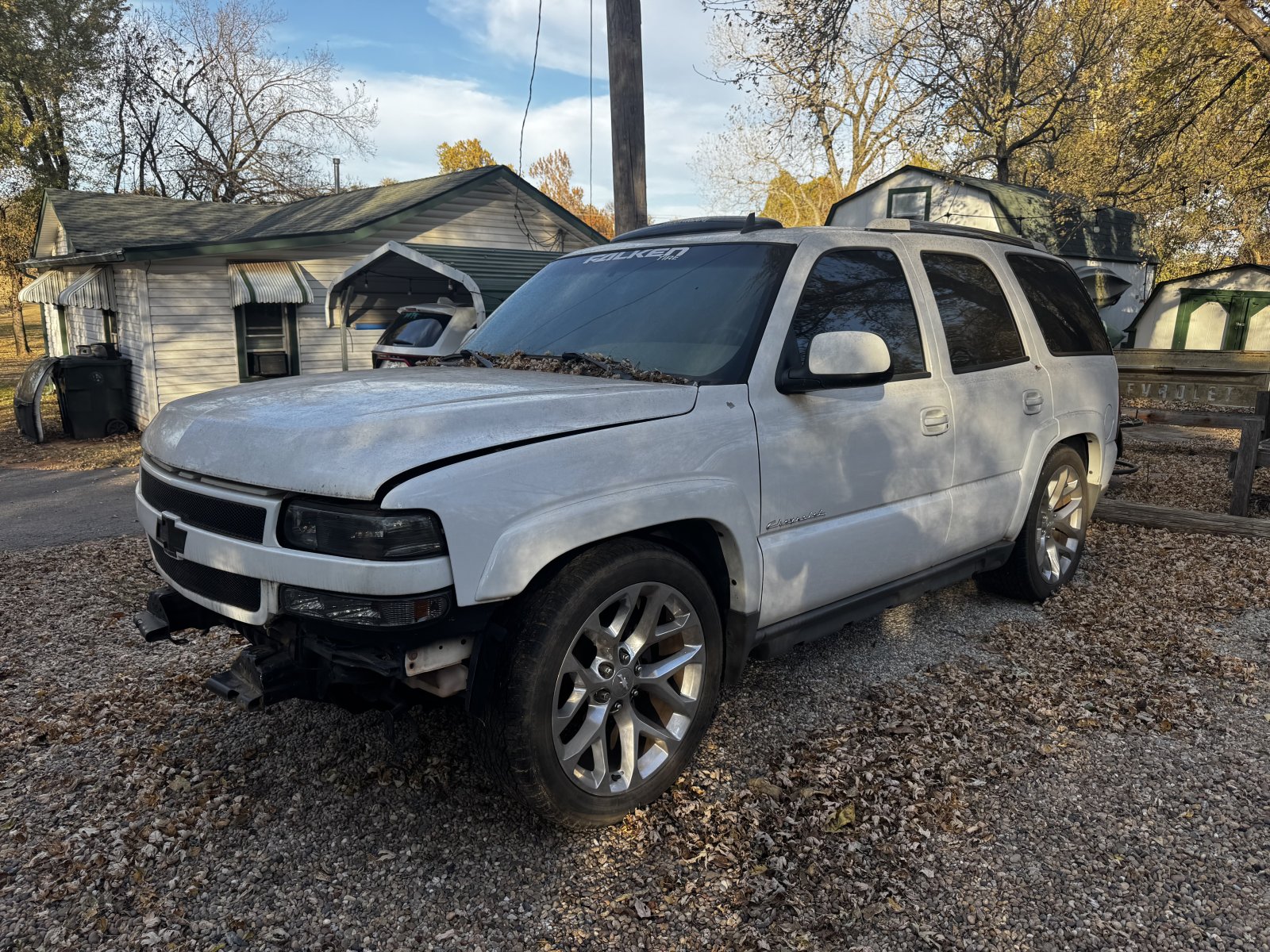

Pics of the truck, please.

Why do you think it's a Z71? If you don't have the Z71 RPO code, you don't have a Z71. What do your roof racks look like? Z71s have flat, horizontal cross braces. Others have arched braces. EDIT: based on your pics someone has replaced the roof rack with the Escalade model.

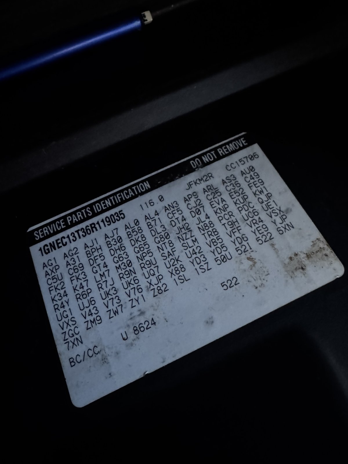

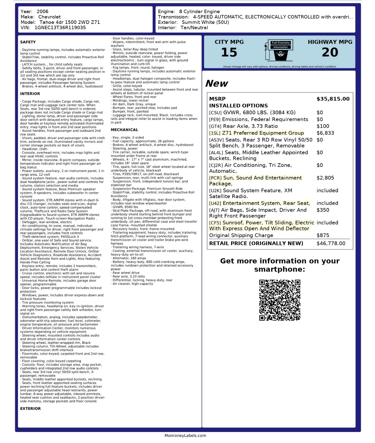

Attached is the Monroney label and SPID from my truck

My truck was built as a Z71 minus the 4x4 as you can see from my previous reply. It has been modified such as the roof rack and the suspension was replaced with heim jointed components.
