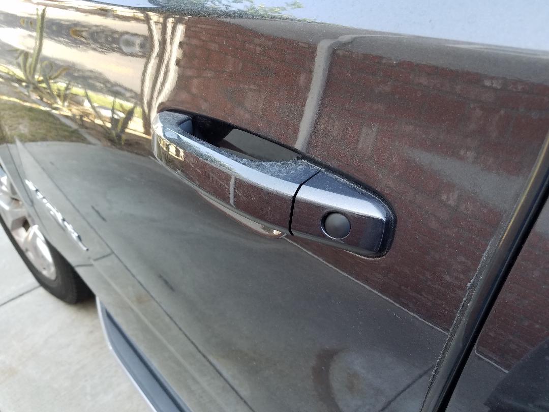

Found these little hole covers from Widget.com, they're made of ABS plastic, available in a number of sizes and at 4 cents apiece, I bought 25 of them (minimum order). I spent about 3 minutes sanding the back profile to match the angle of the handle and slid it in. I intended to paint match it but on my initial test fit, it practically disappeared. A drop of silicone on the back edge of it holds it in place (I don't know how long it'll stay there, but I can remove it if I need to pretty simply). For the money (about 6 bucks, including the "S & H") and the time spent on it it's just about perfect. I may spend a bit more time profiling the back edge on the next one to get it to sit perfectly flush at the angle and blend right in, but as I said, I'm happy with it.
