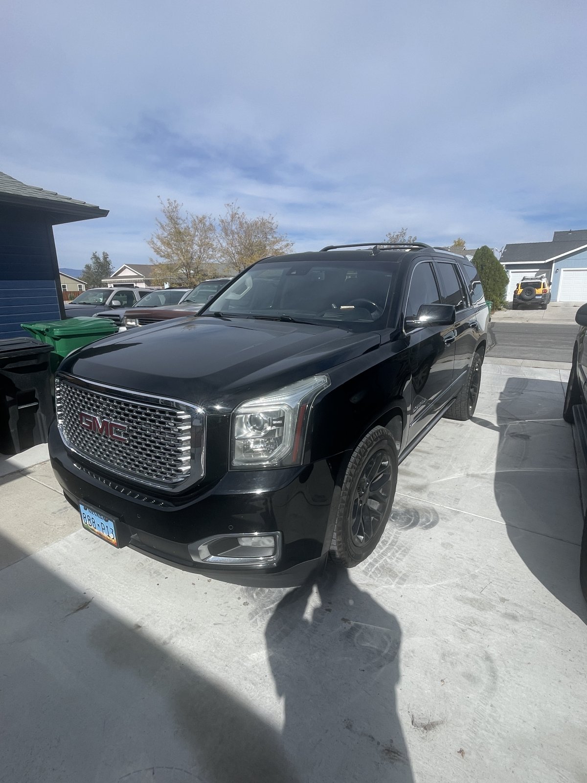

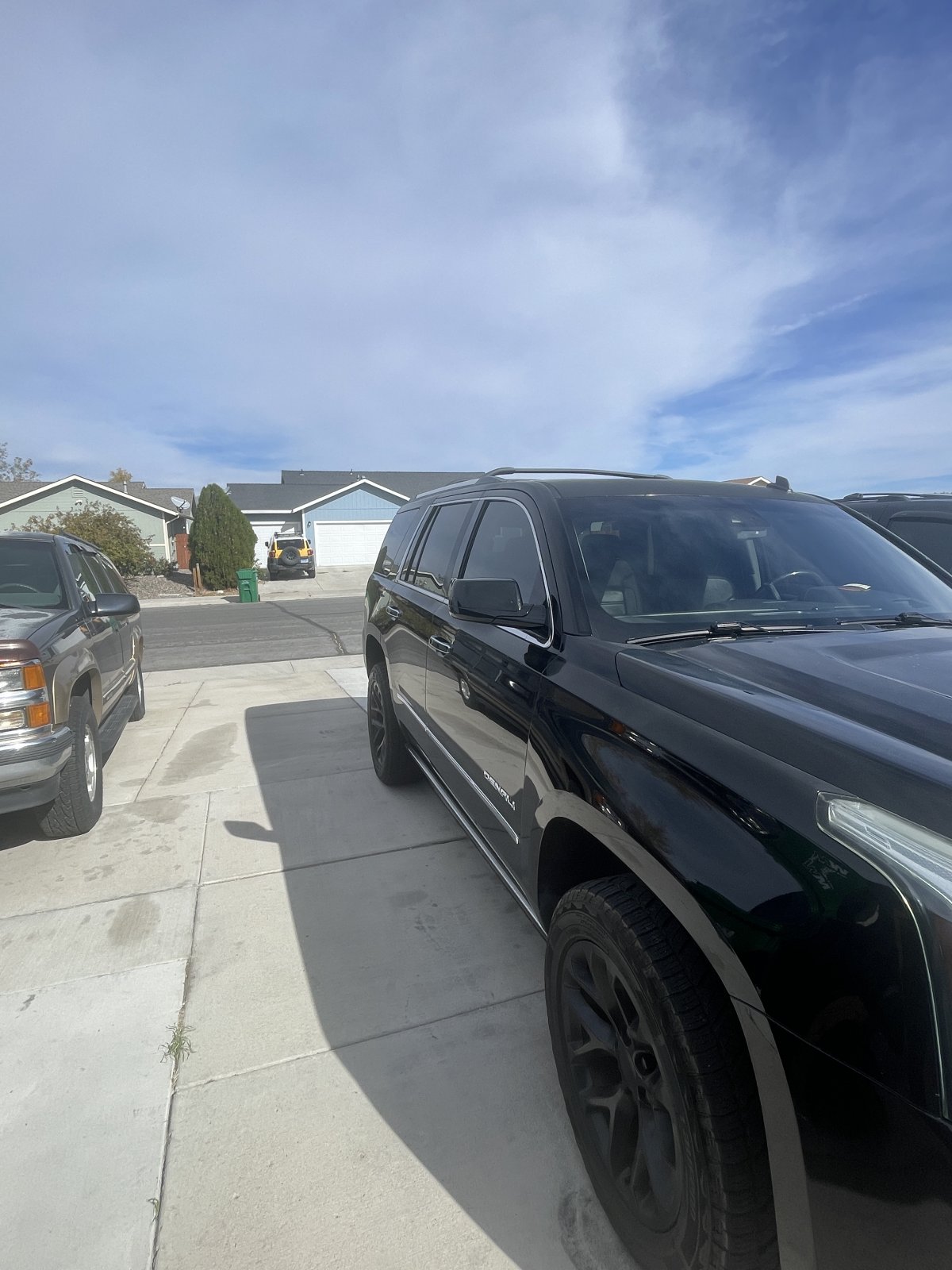

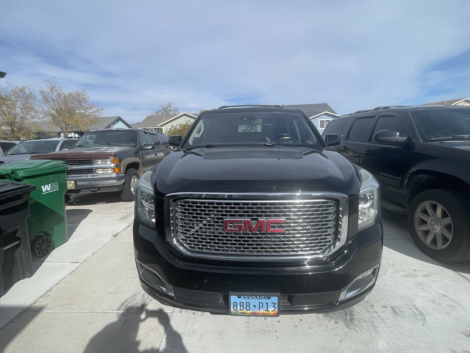

Pics of the truck, please.

Thanks for the welcome Joseph ,
