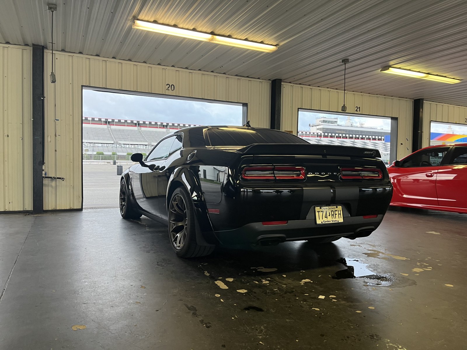

Planning on racing my challenger at a standing 1.5 mile event; it’s a long ride there and I don’t want to drive it all that way.
I have a 2015 Tahoe LTZ and am thinking about renting this uhual trailer:
That car is about 4500lbs. Will I have any problems?

The U-Haul trailer weighs about 3,155 pounds. They will not rent it to you if you tell them you are going to tow a Challenger with it.
The Tahoe should handle it ok. Better if she has the gears and cooling package, if not, slow down a little and she'll handle it ok as well.
I'd slow down anyway with the surge brakes on the trailer! LOL

You only get the different axle and probably cooling too with towing package or Z71. According to uhaul the trailer is 2,210lbs so you're probably right near your towing capacity with a Challenger on it.
