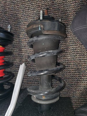

Strutmaster sent me another set of front struts kit. GC3FB. At least the overall length measurement is the same as the oem struts. But the look poorly made. Checked strutmaster web site and kit is made for a 2015 - 2018 Chevrolet Avalanche. Wasn't the avalanche discontinue after 2013. At this point have decided cut my loss and go back with factory.

Recommend getting new shocks from rockauto OEM fit avg. cost around $305.00 a piece and come with lifetime warranty. Try the strutmaster kit with bypass sensors. Bad decision. Ended up just going back with OEM shock from rockatuo. Easy install and fit was correct. Back to very nice factory ride.
