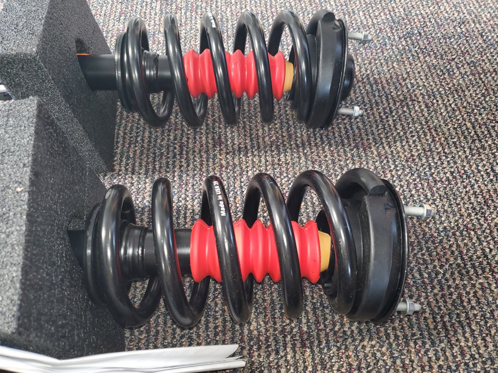

Strutmasters Maybe maybe not
It raised the front 3" and the rear drop 1/2" so from ground to wheel well is 37 1/2 in rear and also 37 1/2 in front. This was a shock and spring replacement front and rear. Ride is very floaty feel. Also rocks side to side pretty bad when going over bump at a angle. Pulling into driveways est. Believe strutmaster has got the set up wrong for the 2015 and up. Kit was a GC2FB (2007-2012) Was suppose to be kit GC44F (2015-2018). Sales Rep said it the same shocks and springs in both kit. Just the electric bypass kits are different. Working with tech support about getting the front back down to the shock height.
For mag delete they supplied resisters with water tight fuse. Just cut connector off old shock wire in the resister wire hardness. Also just remove fuse for air pump. No warning lights so far.
For now I'm disappointed in kit. It rides better with the wore out front mag shocks. Probably will just go back to mag ride shocks. If strutmaster can't correct. Rockauto has the for around $318 a piece. Total cost around $1300 plus my labor. Strutmaster kit was $737.38 plus my labor about 6 hrs so far.
Today had serval calls from strutmaster.
Rep from strutmaster is going to seen me a new design strut kit. Going to try and get the front end back down. and a shifter spring. We'll see what they come up with.

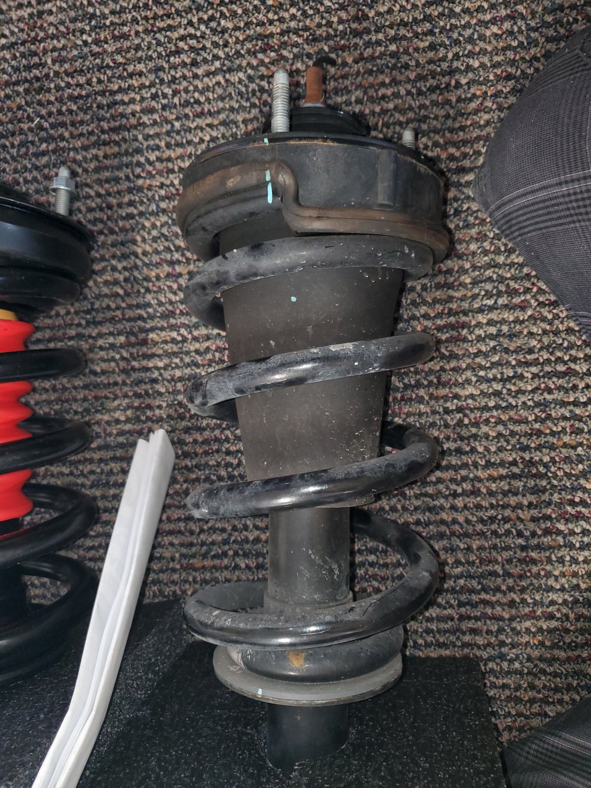

Strutmaster sent me another set of front struts kit. GC3FB. At least the overall length measurement is the same as the oem struts. But the look poorly made. Checked strutmaster web site and kit is made for a 2015 - 2018 Chevrolet Avalanche. Wasn't the avalanche discontinue after 2013. At this point have decided cut my loss and go back with factory.

Recommend getting new shocks from rockauto OEM fit avg. cost around $305.00 a piece and come with lifetime warranty. Try the strutmaster kit with bypass sensors. Bad decision. Ended up just going back with OEM shock from rockatuo. Easy install and fit was correct. Back to very nice factory ride.
