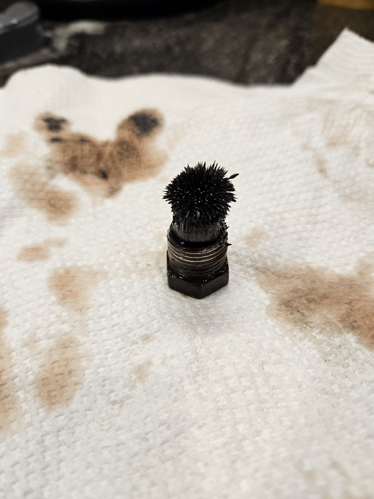

Drain plug for the tcase.
Seems like a lot of metal to me.. no big chunks though.
