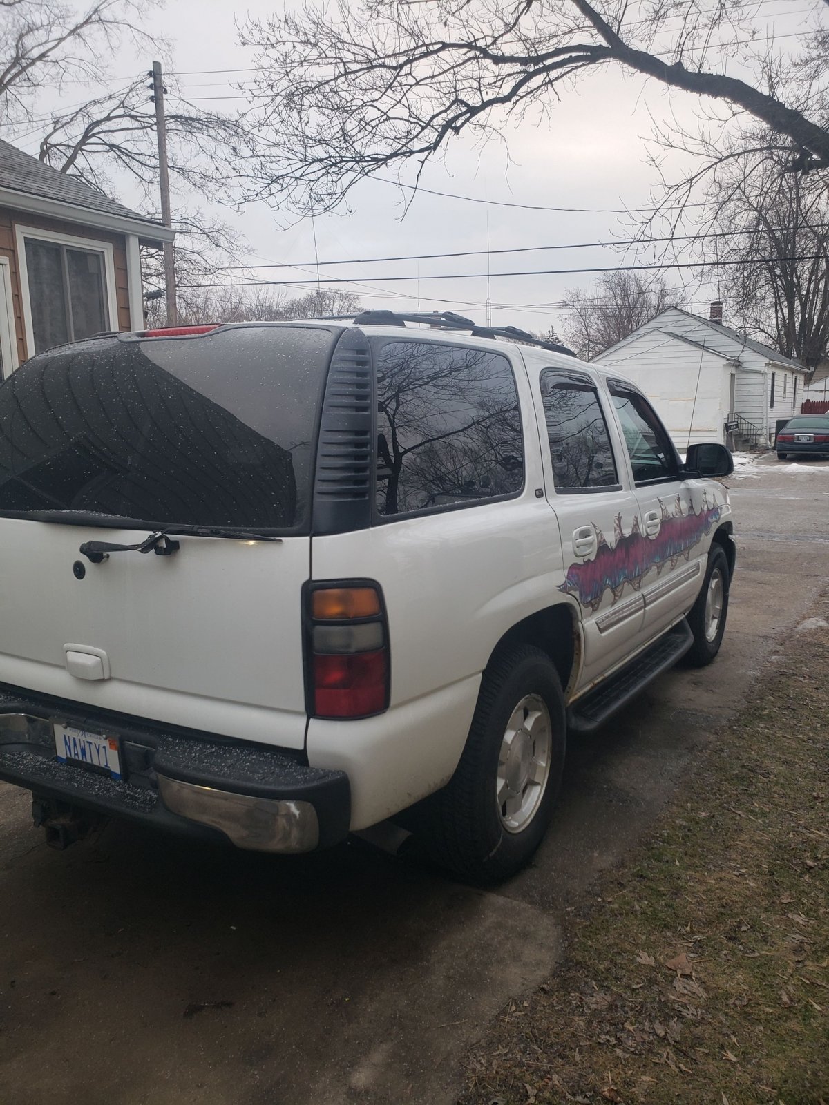

Pics of the truck, please.

I will be coverting all extrior lights to LED and installing my off road lights to the roof that I had on my 07 Ford Expedition EL. I truly can't believe how well the LED's make it better for night time driving.
