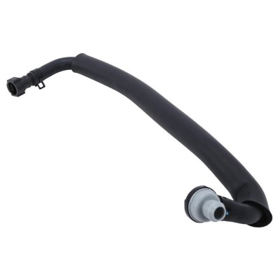

Low RPM means highest vacuum. If you have a vacuum hose coming off the brake booster, replace it. They deteriorate over time and can collapse on themselves under high vacuum.
Essentially slow speed, high vacuum, hose collapses on itself and then zero vacuum and hard pedal until hose unsticks.
any idea about the part number for this hose?

Double check compatibility. R/A is outta stock. P # 42477121
Just noticed in previous post he replaced vacuum pump. I guess that was what the part # request was for :cool:
