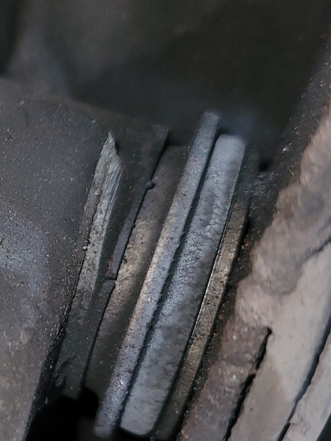

here is a close up of the UCA bushing. The tahoe has about 60k miles on it. the sqeaking/clunking noise had been going on for close to a year before i swapped the struts and is still there so its not the struts. squeaking is rubber against metal sound. I will stick with the gm parts from here out.
going to take a closer look at the rest of the mounts. thanks for all the info!
