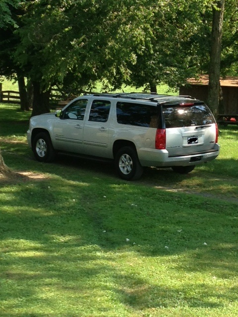

Just got it in the mail. Passenger side airbag recall notice. Vehicle is a 2014 Yukon XL with roughly 78,000 miles on it. Very good condition.
I have a couple of questions.
Do they have to pull the dash to do this repair? Just how intrusive is this job? I don't want to get it back with rattles.
If I do decide to get this work done, should I pull the AFM Range Disabler before dropping it off?
Is this something I really need to be concerned about?

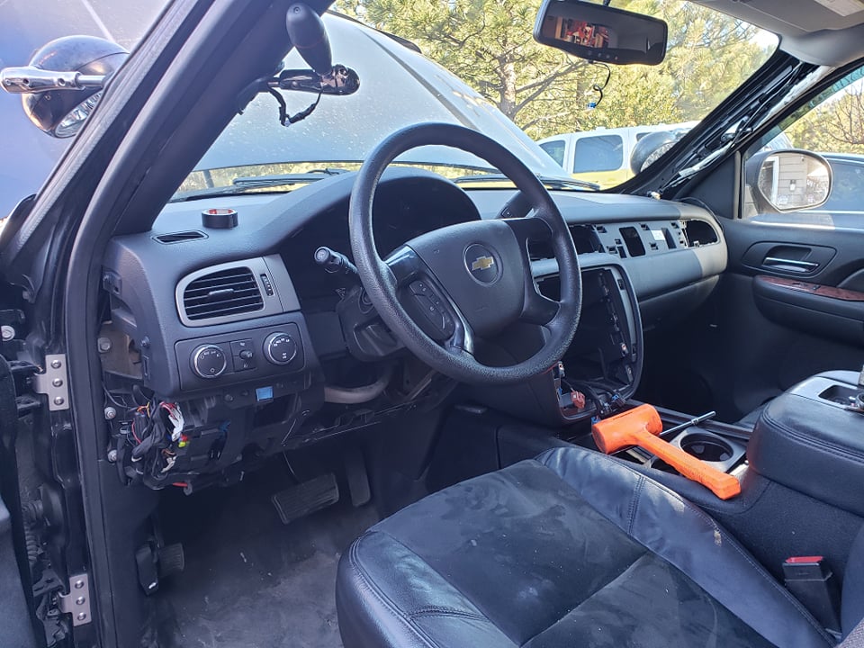

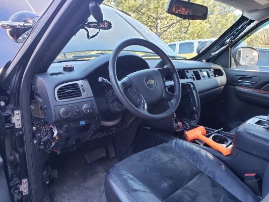

My dash was cracked in 3 places before the Recall but waited until after the airbag was replace before replacing with a new dash board.

I replaced mine before. What they do isn’t going to crack a dash unless it’s brittle in which case it’s going to crack on its own.
