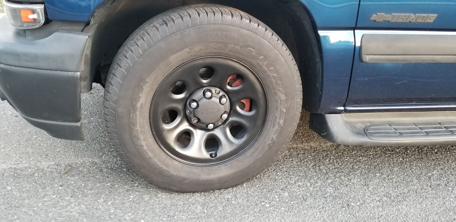

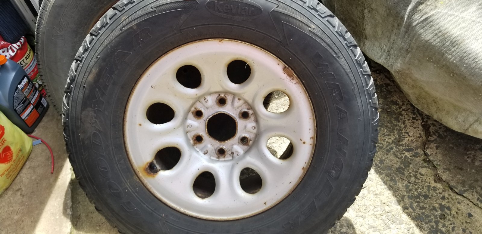

You could always drill new holes, or try to retap your messed up holes. I bought some Silverado 17's and drilled and tapped bolt holes for the center caps. 20200503_145645.jpg20200505_165403.jpg20210406_191136.jpg
