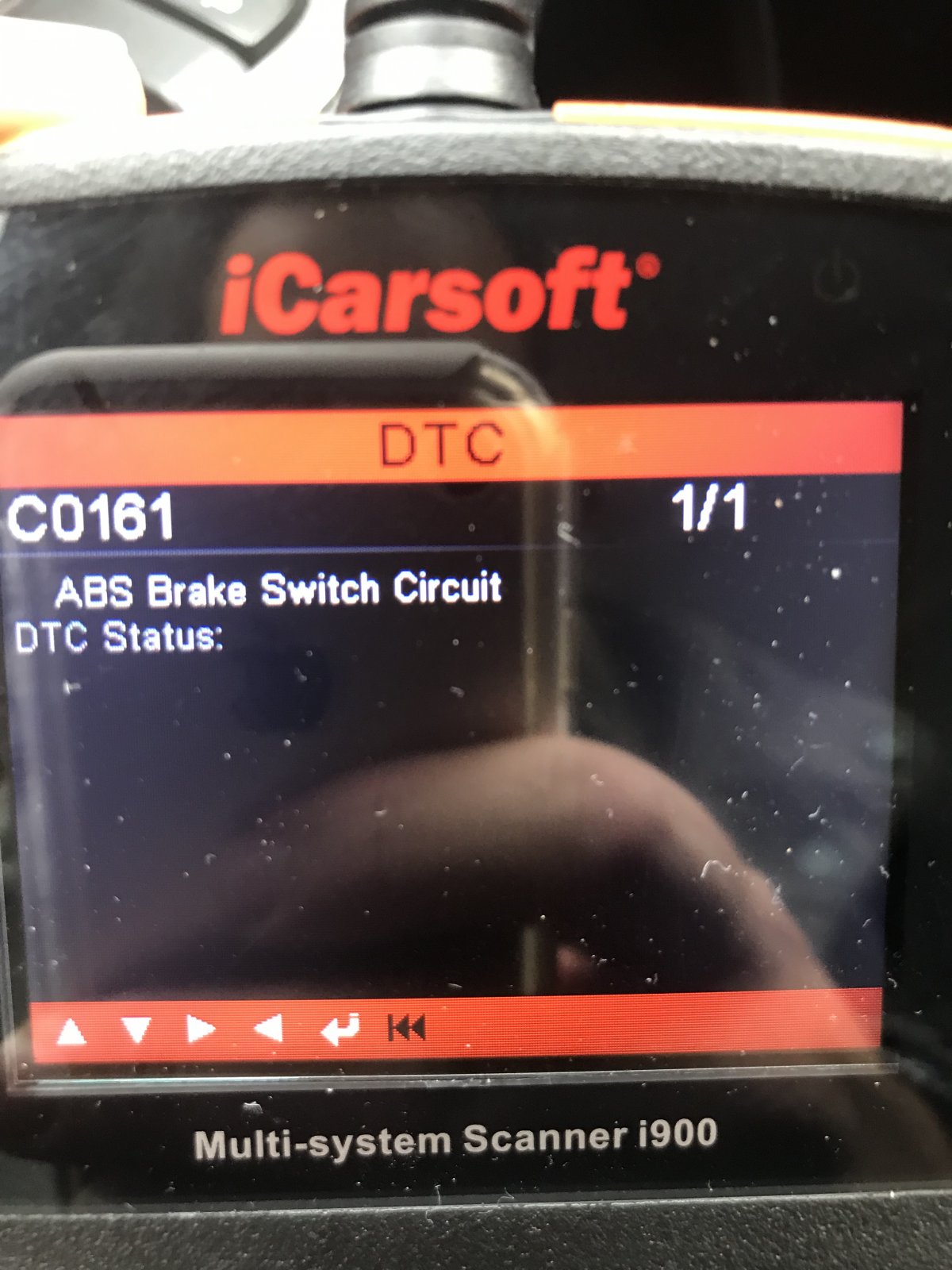

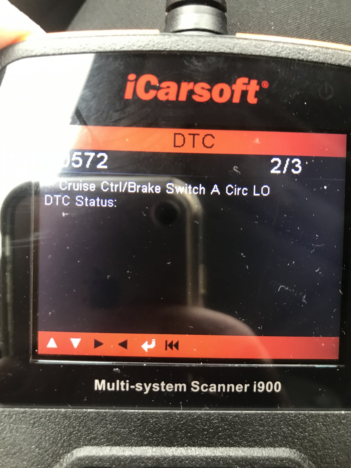

Likely its the brake light switch. Had the same issue where all lights worked fine and no check engine light, but did see the code for the brake light switch when using my scanner.View attachment 232620
