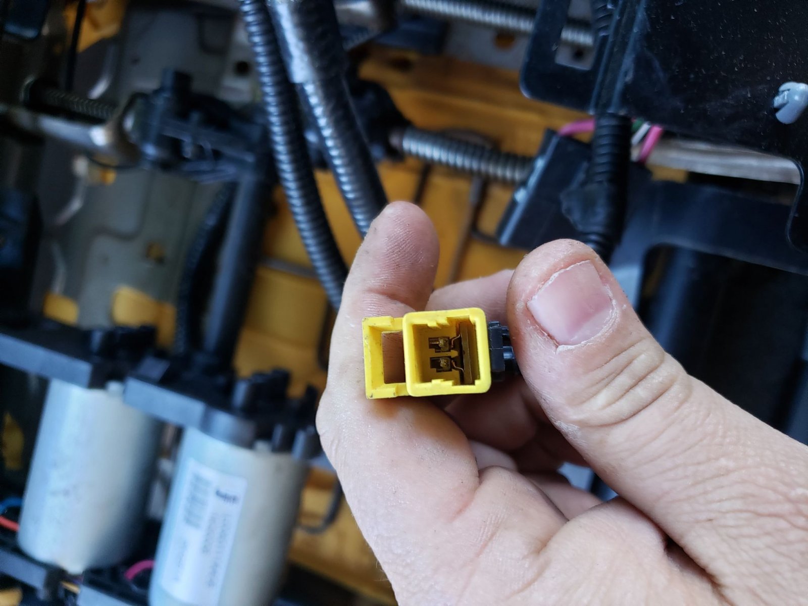

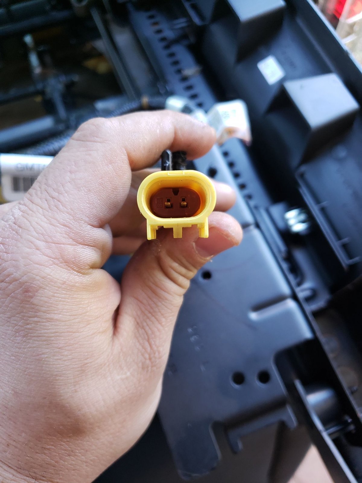

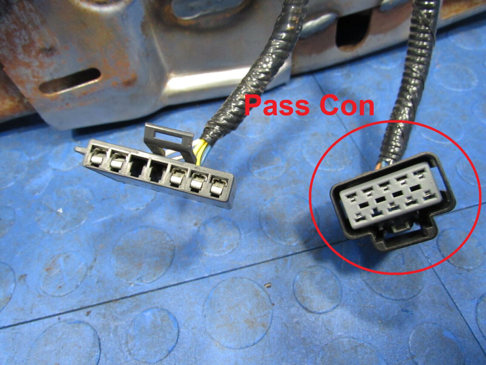

If it has a seat airbag make sure the connectors are the same ran into this issue Square plug and Round plug. Learned the Hard way there was 2 types it is a easy swap if you cant get the correct one.

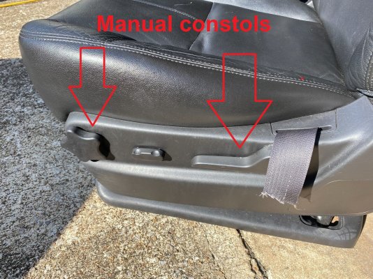

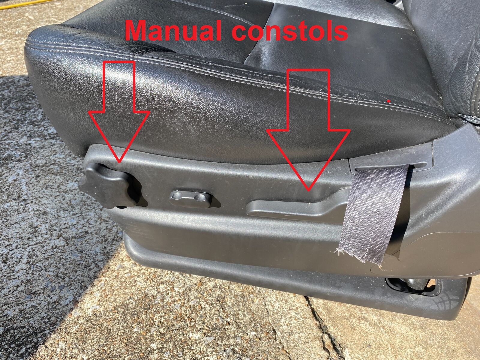

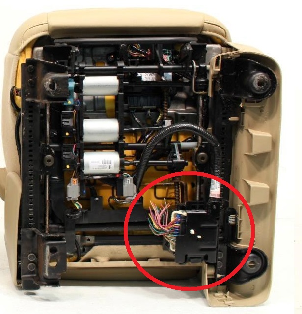

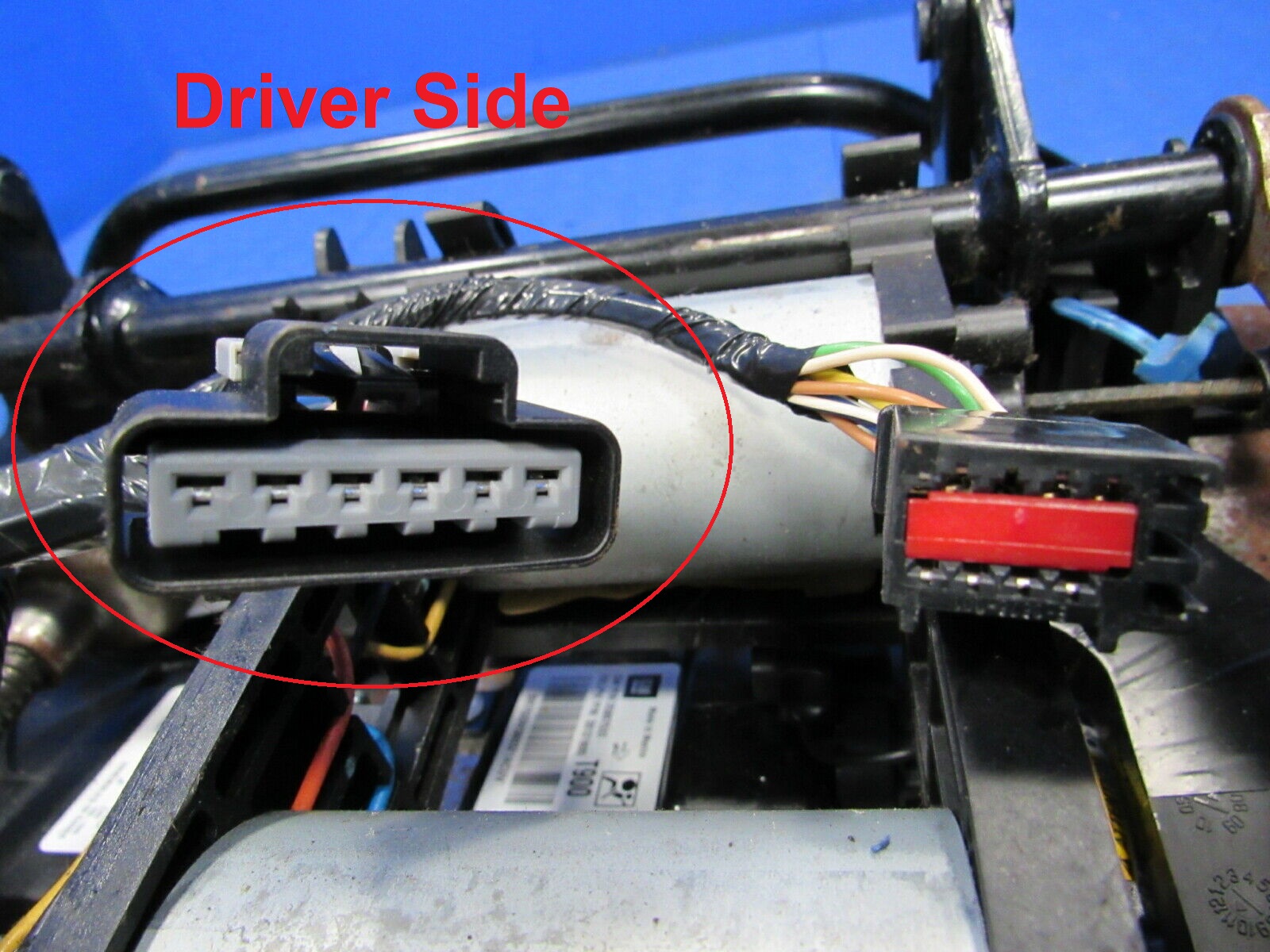

there is that I know of 3 styles of connectors Locking style like the tan seat that one has all the options usually known and 6/8 way adjustable, One marked driver side is your usual PPV/SSV seat connector seat only goes forward and back up and down photo below. Have issues finding the 3rd style of connector. If your going to rewire really need power, ground, Seat belt, and Pressure sensor.
Have to dig out wiring diagram for seat connectors have it somewhere.
Also check your glove box for the RPO codes will tell you a lot what is installed/Deleted in your Gm Product example below @dhwright
If all else fails you can buy new leather seat covers from Ebay or leather company and do it yourself if the seat foam is in good shape.

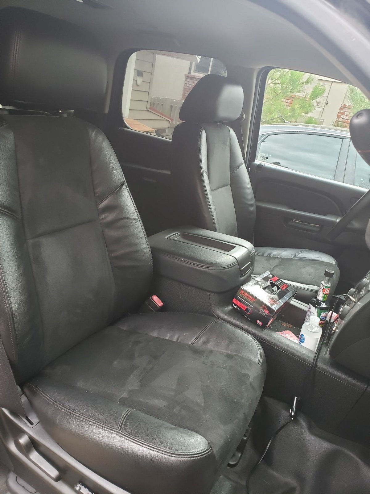

I went a different direction with this issue, I bought new leather seat covers, and seat bottom foam from The Seat Shop, then bought OE GM back foam. I did this back in March 2021, and the seats are as comfy as any truck seat I've sat in, and are holding up great. We have over 60k on the truck since I did this work.
