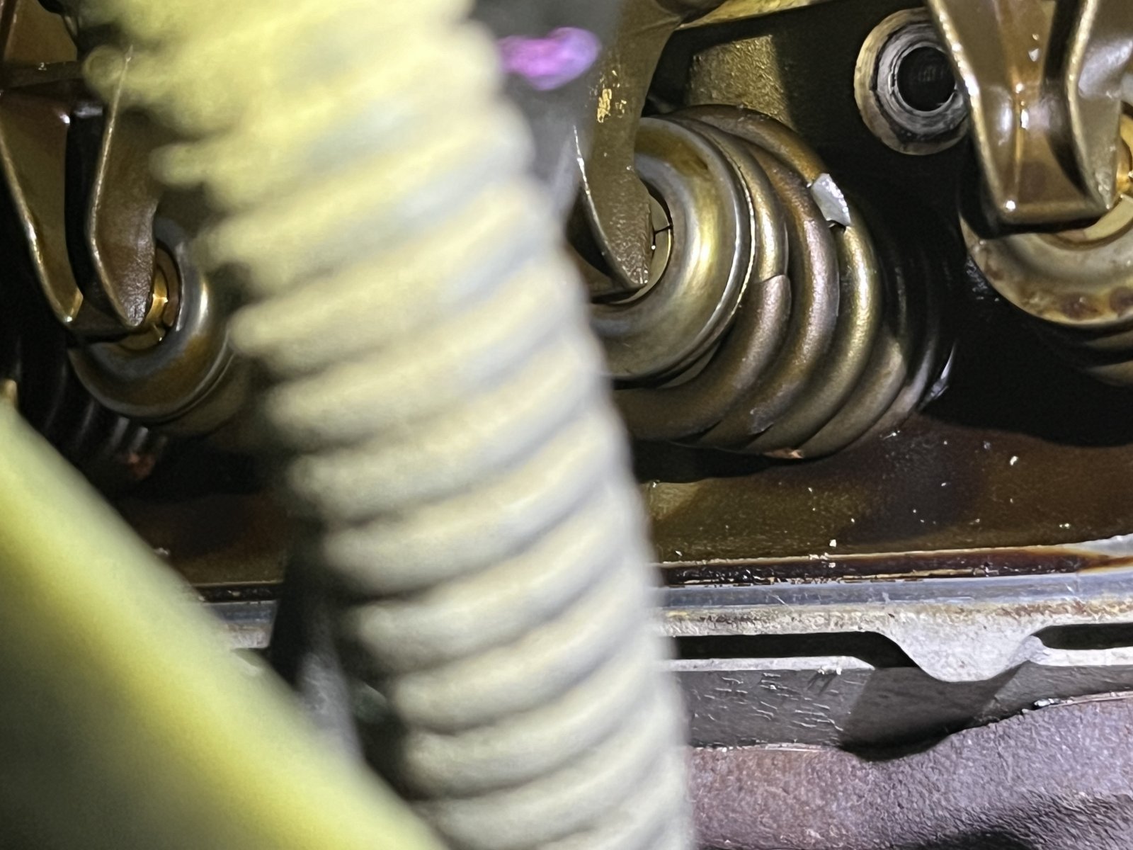

Possible broken valve spring.
I just replaced a broken valve spring on my 2013 Denali. Had it towed to a local shop that said they did diagnostics on it and gave me a quote for $5500 to replace the lifters. Told him I’d do it myself and had him tow it to my house. Spent 45 minutes removing the valve covers and found a broken valve spring. Got lucky that there was no damage to the valve or piston and got it back up and running.
mountie
May 9, 2018
7,058
13,797
I just replaced a broken valve spring on my 2013 Denali. Had it towed to a local shop that said they did diagnostics on it and gave me a quote for $5500 to replace the lifters. Told him I’d do it myself and had him tow it to my house. Spent 45 minutes removing the valve covers and found a broken valve spring. Got lucky that there was no damage to the valve or piston and got it back up and running.View attachment 440732
That is an 'ouch'....... I hope my '05 5.3 doesn't do that..... Or is it on your newer engines?
