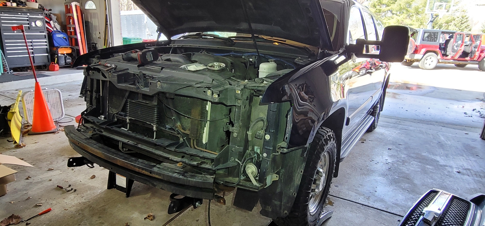

I ran the experiments of different routing of the plumbing for the cooler, including taking the radiator's oil-to-water cooler out of the system entirely back in 2021 and it didn't work. Couldn’t keep temps under control. It’s all documented here: https://www.tahoeyukonforum.com/thr...ontrol-when-towing-in-the-summer-heat.125753/
The GM upfitters manual is also clear that any aux cooler should be plumbed inline after the radiator and before the transmission in the fluid path.
I considered moving the trans cooler to behind the radiator but that creates several complications for the fans and other clearances. In the end I decided that since I have a lower grille on the Denali, I would locate the Derale there and punch out the plastic plugs to get airflow to it. I've found it to be about the perfect setup for towing near the max rated capacity of the truck.
