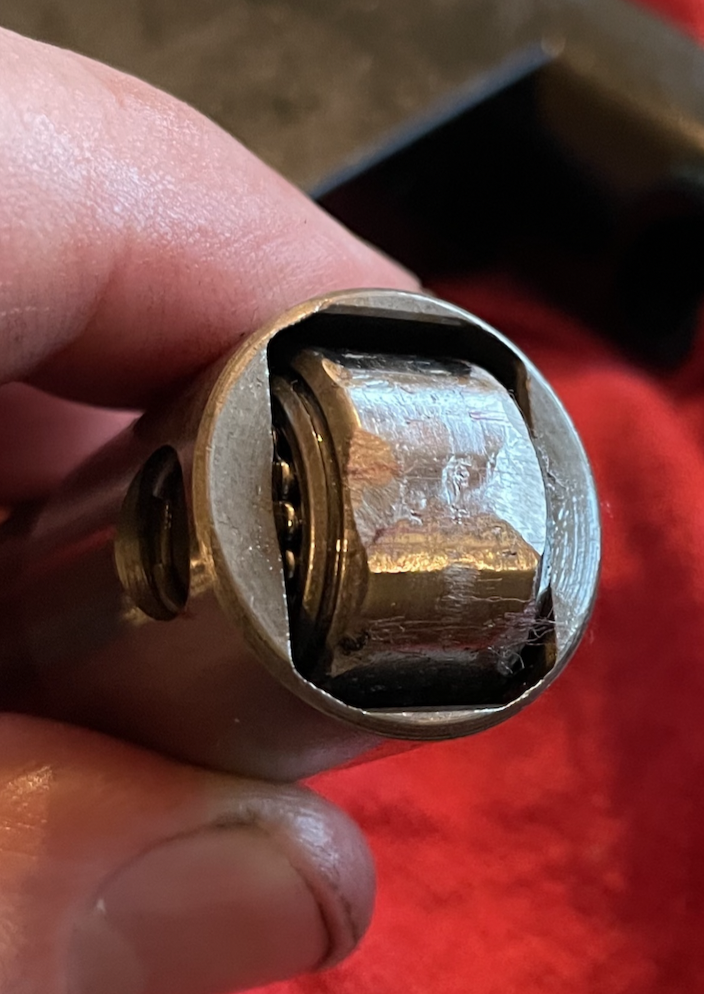

You have a lifter failing and is in the process of wiping the cam. Get that thing out of there before you have real damage to the engine.
Here's what mine sounded like along with a shot of what one of the lifters looked like when I got it out.

Thank you for sharing that. I will get the heads pulled and see if I can salvage the cam and engine.
Good call. My bet is it's going to be okay, depending on how much metal came off that lifter. Might have a little damage to the oil pump, so it might be worth replacing that as well, and then running a couple of 500 mile oil change intervals to get any remaining metal out. Oh, and a magnetic drain plug.
Just curious, when the TSP cam went in, did you (or the installer) use AC Delco lifter trays?
