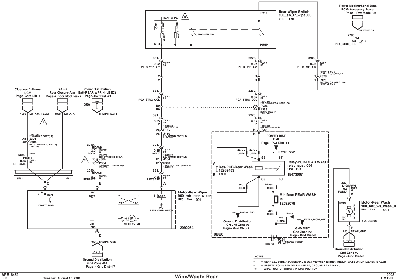

Just purchased a 2013. Everything works except the rear windshield washer motor. Checked fuse, swapped with known good fuse, replaced steering column stalk switch with a new one, removed rear washer pump and hooked up to battery and the motor works.
I've looked for, but haven't found a wiring schematic for the washer pump circuit to see if there are any related relays. Does anyone have any experience troubleshooting no power to the rear washer pump?

Looks like the relay is one of those mounted inside the main fusebox...
-IF- that's the culprit, I've only seen people replace the main fusebox so far..

No power to the rear washer pump when the switch is pushed. Switch has been replaced with a new switch.

I would check at the fuse box to see if the fuse is good and to see if there is continuity between the switch and fuse and from fuse to pump.
should be a normally open circuit and constant ground.
