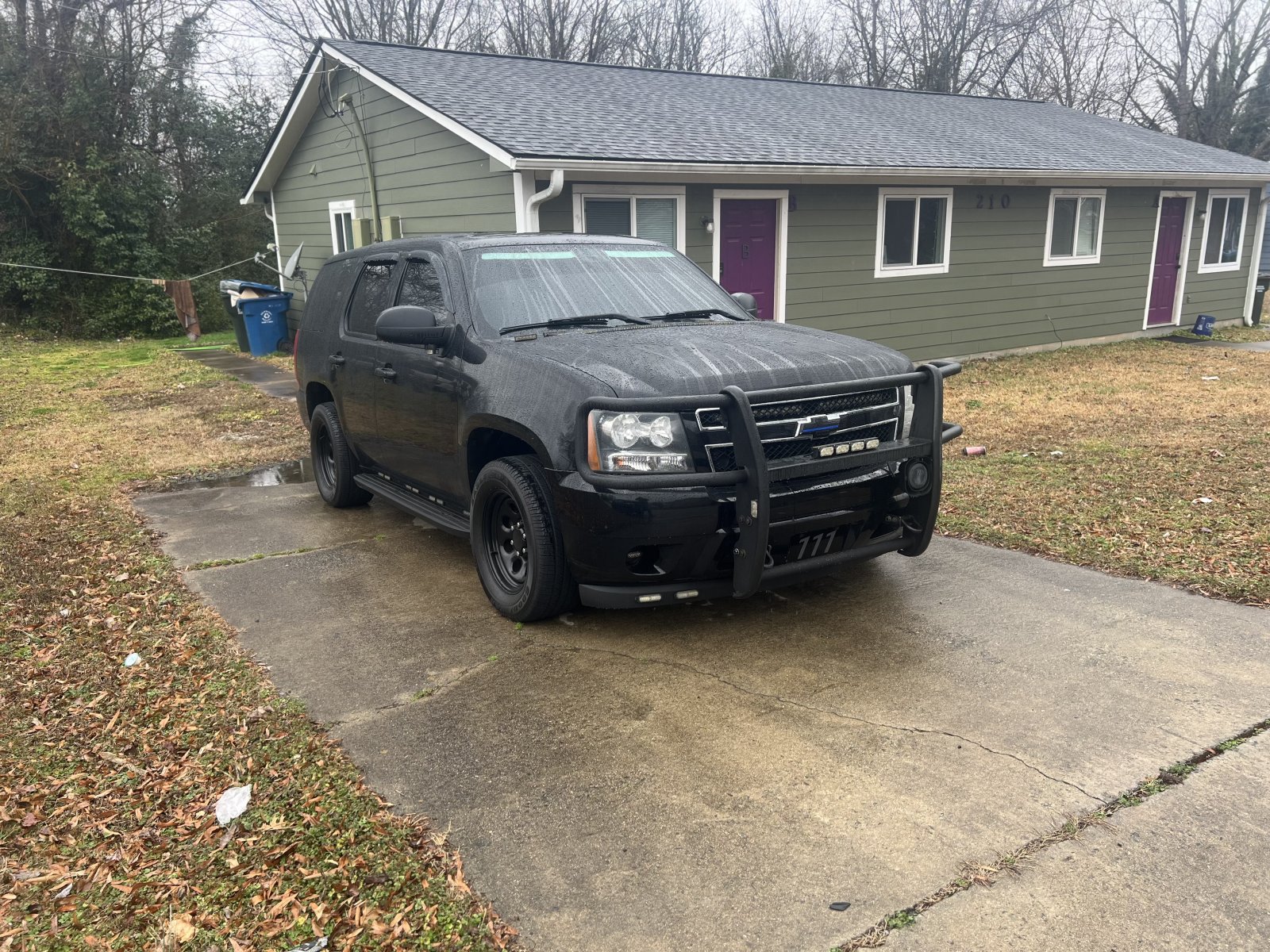

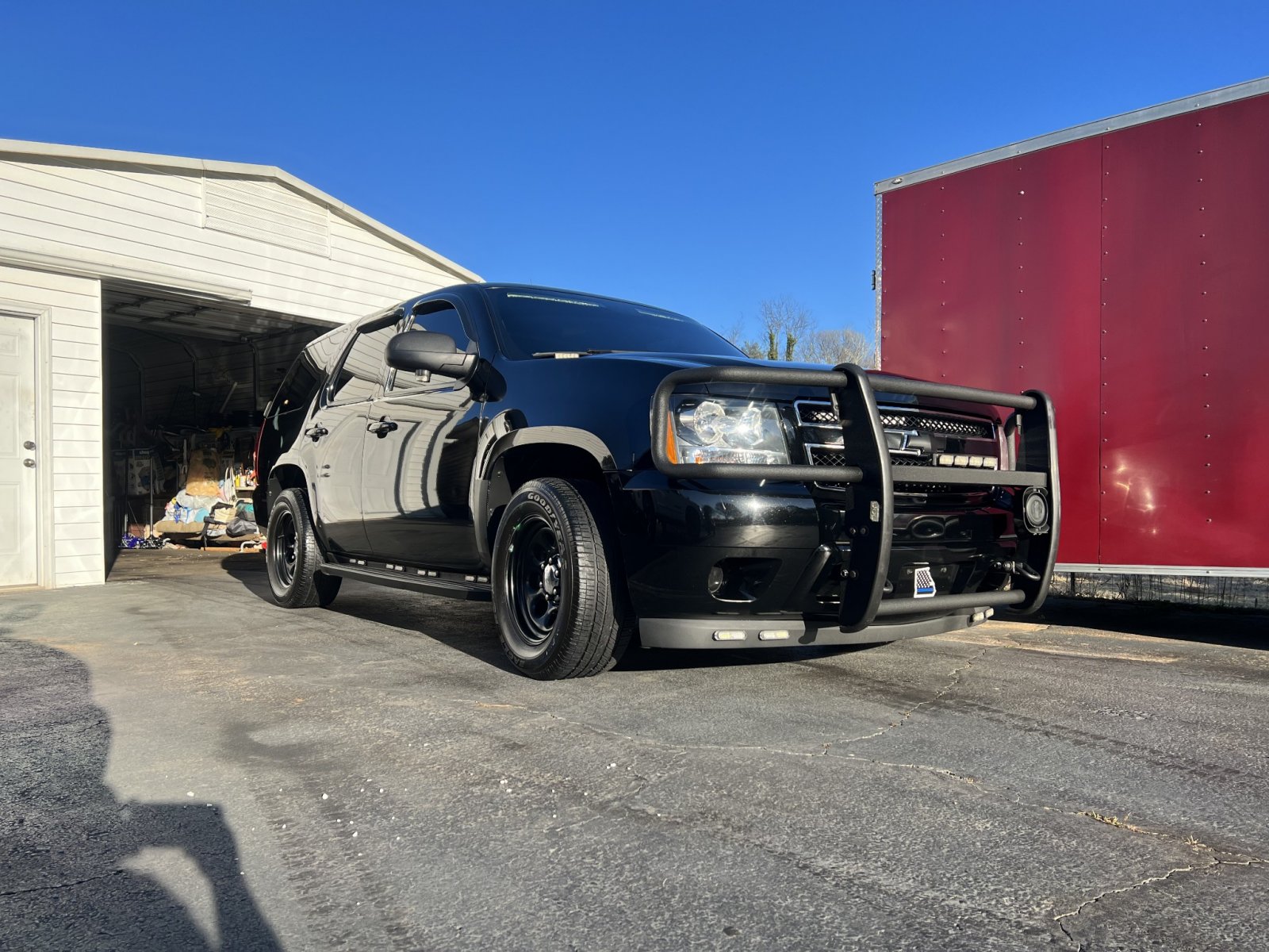

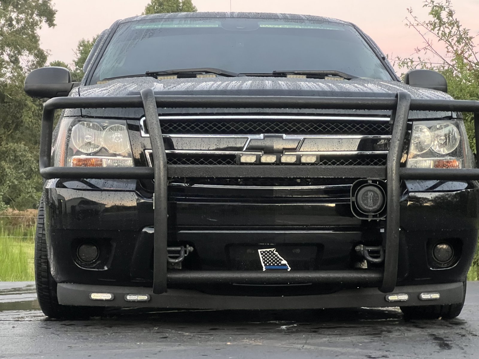

Hey guys, just joined the forum for knowledge. Bought a 2013 Tahoe PPV and absolutely love it! I would like a little more pickup though, thought about a tune, gear change and some minor stuff. I don’t want to cause more wear and tear on the engine or trans, just want to make it quicker.

I really love that bottom front trim piece. I need to find that.
