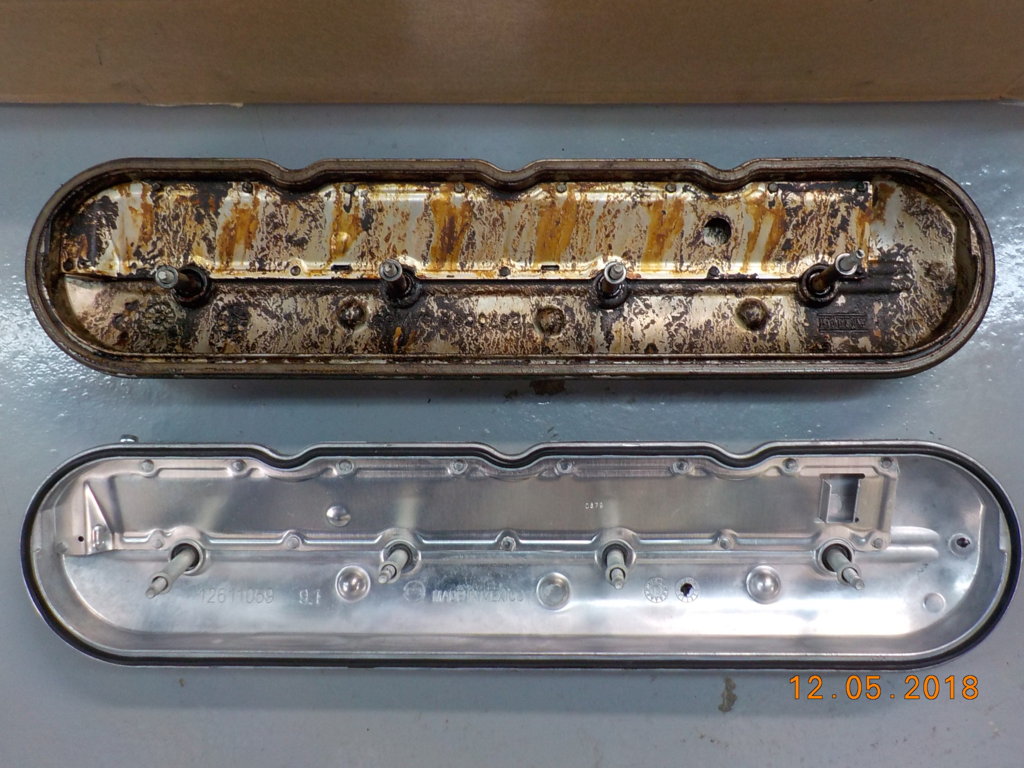

I believe your 2013 HOE came from the factory with the new improved valve cover. Below is a pic of my dirty old vc(top) off my 07 6.2L, and my new improved vc(bottom). Look at the upper right of each. The new improved vc has a square pvc port with flaps, the old has a round port. You'll know when you get yours off.

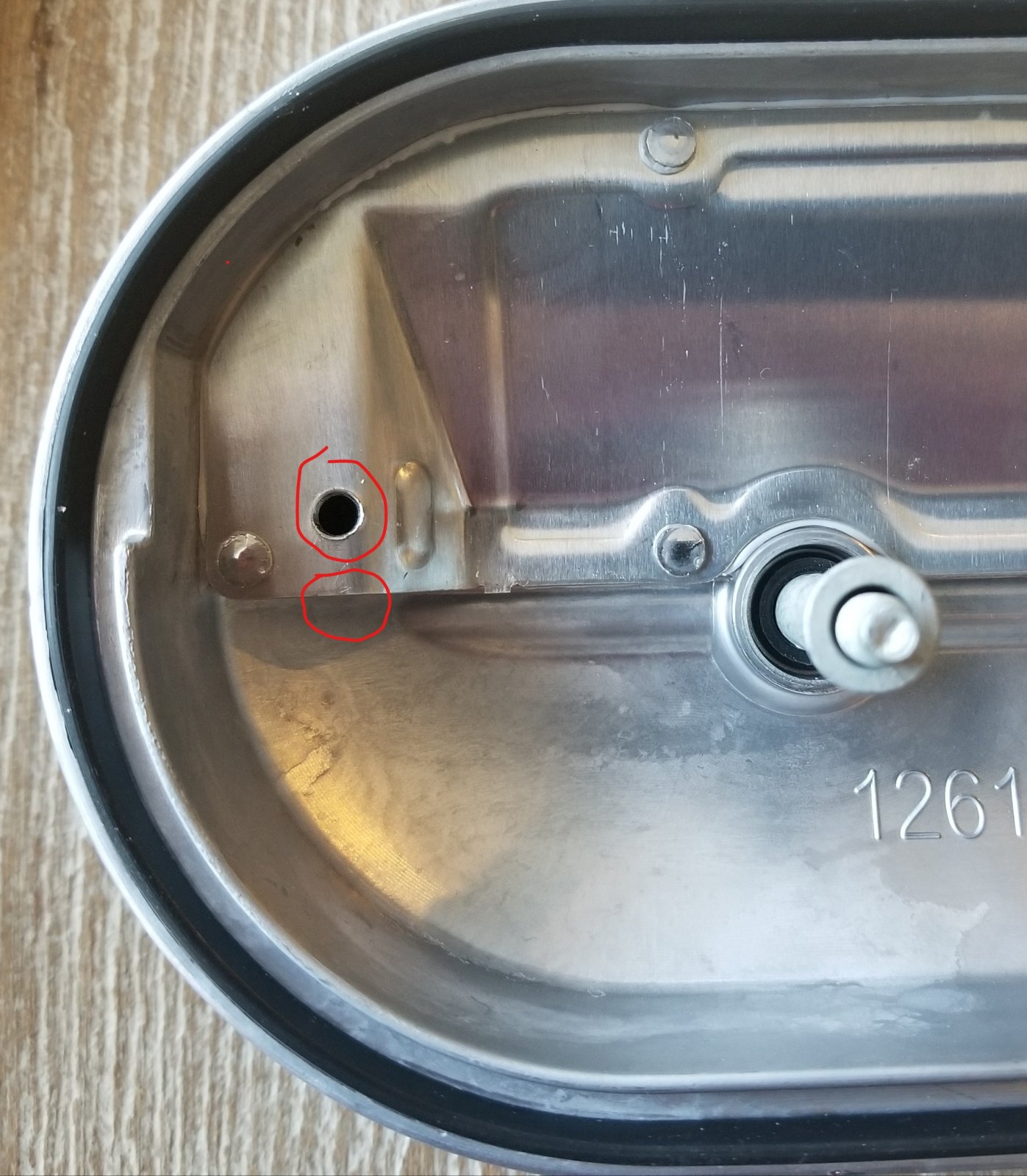

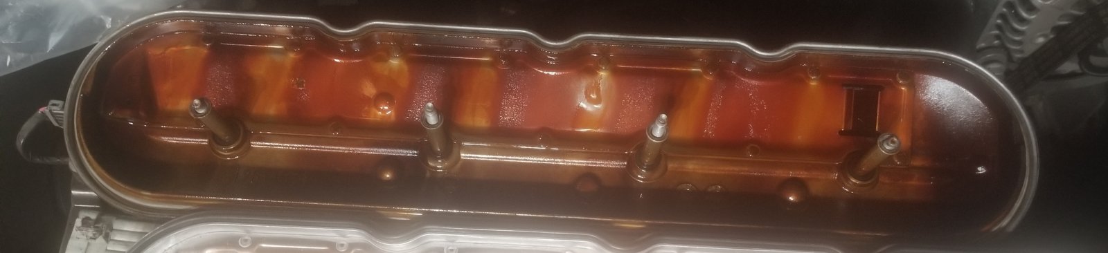

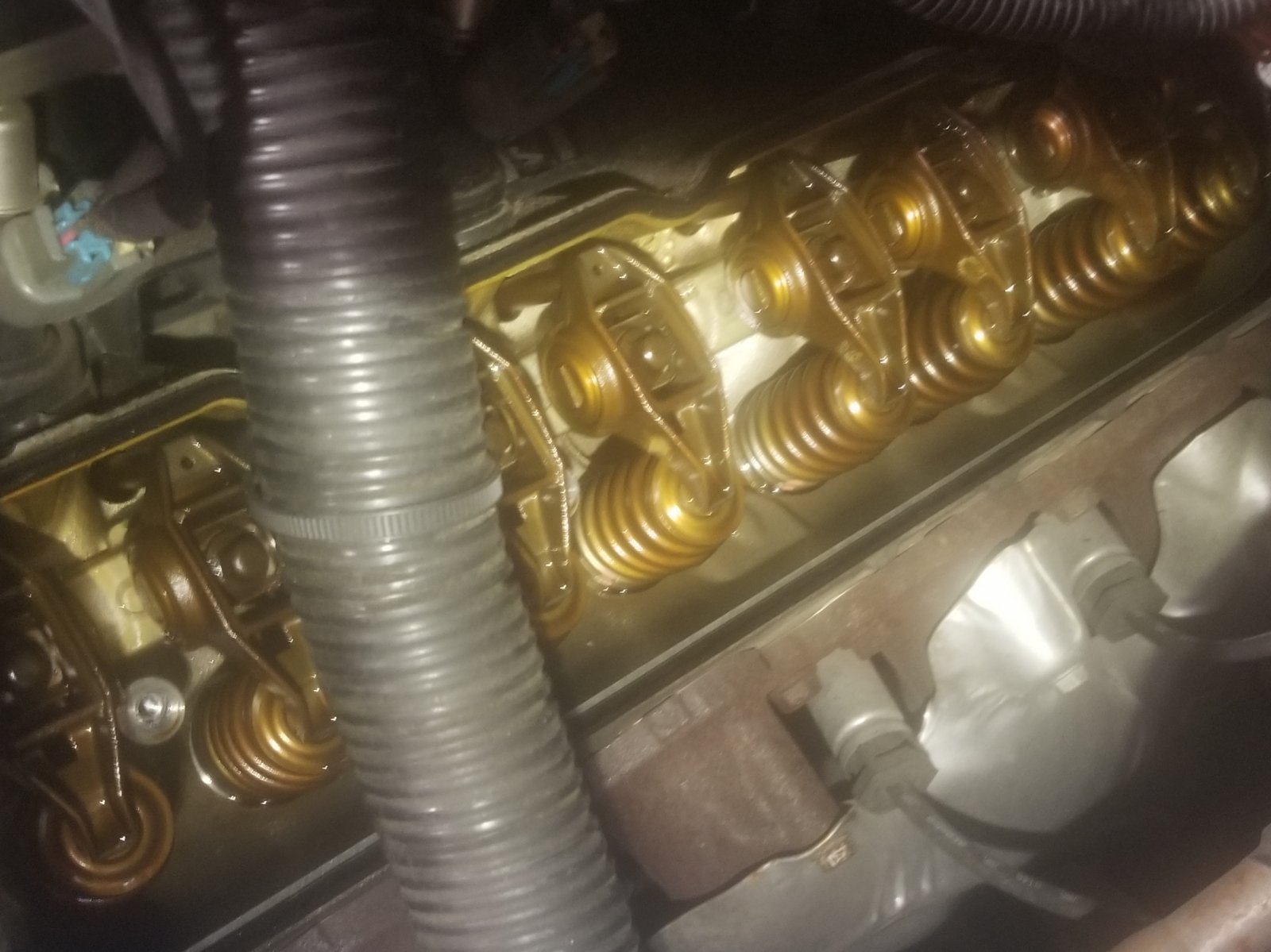

You sure about that updated valve cover bud? I’d take another look if I were you.

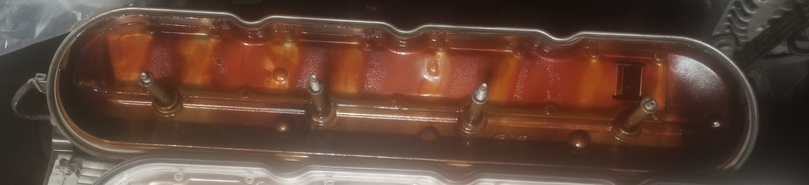

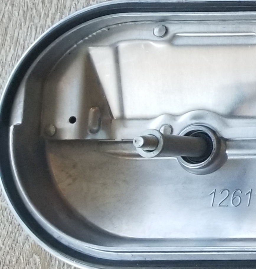

You were 100% correct, the 2013 has the new style valve cover , but the drain hole in the PVC drain was patricianly clogged. I have a 2013 Tahoe with 130,000 miles and noticed having to add 1-3 qt oil between changes. Researched WWW and found one issue was the drivers side valve cover design and GM finally changed the design. I found out that about 2011-2012 the new design started being put on. All my process of elimination still pointed to the cover with PVC drain hole getting clogged. I ordered a new GM OEM part # 12642655 from RockAuto , all gaskets and bolts ( about $70.00). I enlarged the std 7/64 drain hole in the PVC baffle to a 5/32 hole, I also put additional drain below the baffle plate. I removed my original valve cover and found that the PVC drain hole was slightly clogged and most likely causing oil to be sucked back into the intake. I could have put in a catch can but wanted to try this first. The top end looks real clean, due to scheduled oil changes and all lifers are tight without any play. I have included some pictures of the old cover ( the clog is hard to see) and the new cover with the modified drain hole. I will monitor the oil consumption.

yes you do have the new improved valve cover.
You shouldn't be consuming that amount of oil between changes. If you had a catch can, you would know if it was being sucked to the intake. It could be getting by the rings and/or valve seals. If it's the rings, they may be stuck, in which case you need to do the cylinder soak like I did with a solvent like Gunk brand Motor Medic.

View attachment 266810 View attachment 266811 View attachment 266808 View attachment 266809 You were 100% correct, the 2013 has the new style valve cover , but the drain hole in the PVC drain was patricianly clogged. I have a 2013 Tahoe with 130,000 miles and noticed having to add 1-3 qt oil between changes. Researched WWW and found one issue was the drivers side valve cover design and GM finally changed the design. I found out that about 2011-2012 the new design started being put on. All my process of elimination still pointed to the cover with PVC drain hole getting clogged. I ordered a new GM OEM part # 12642655 from RockAuto , all gaskets and bolts ( about $70.00). I enlarged the std 7/64 drain hole in the PVC baffle to a 5/32 hole, I also put additional drain below the baffle plate. I removed my original valve cover and found that the PVC drain hole was slightly clogged and most likely causing oil to be sucked back into the intake. I could have put in a catch can but wanted to try this first. The top end looks real clean, due to scheduled oil changes and all lifers are tight without any play. I have included some pictures of the old cover ( the clog is hard to see) and the new cover with the modified drain hole. I will monitor the oil consumption.

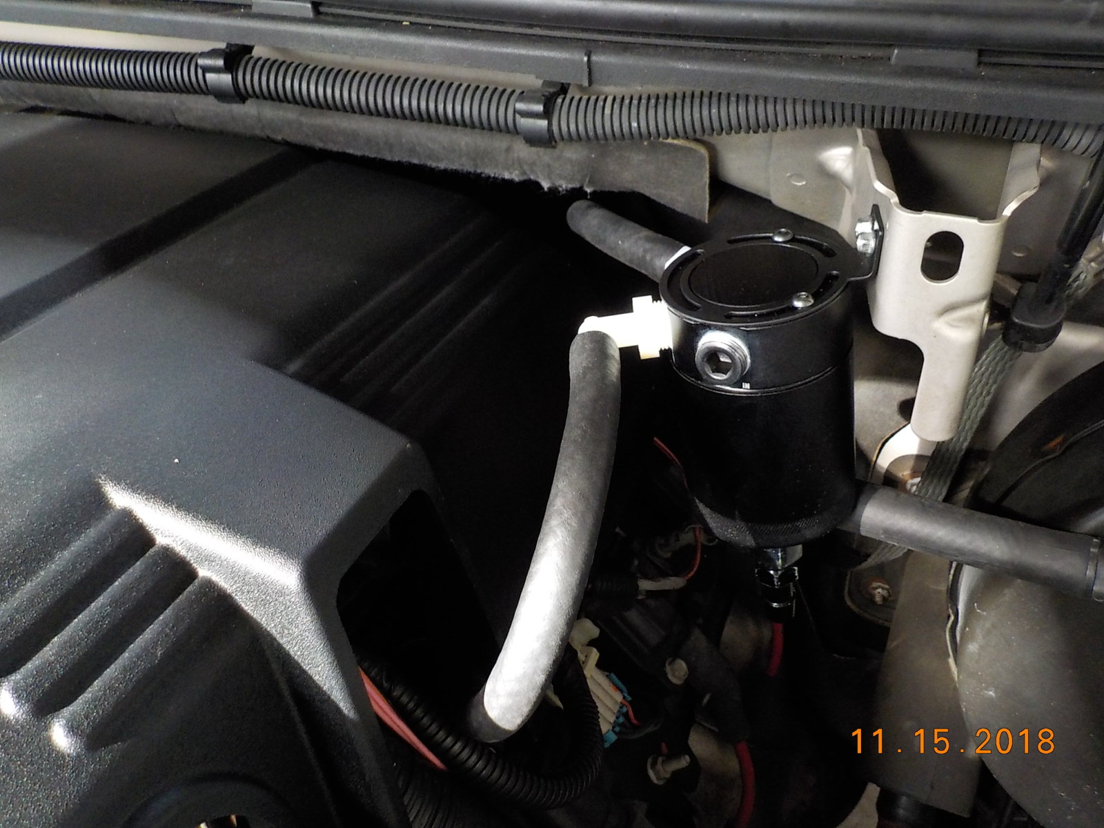

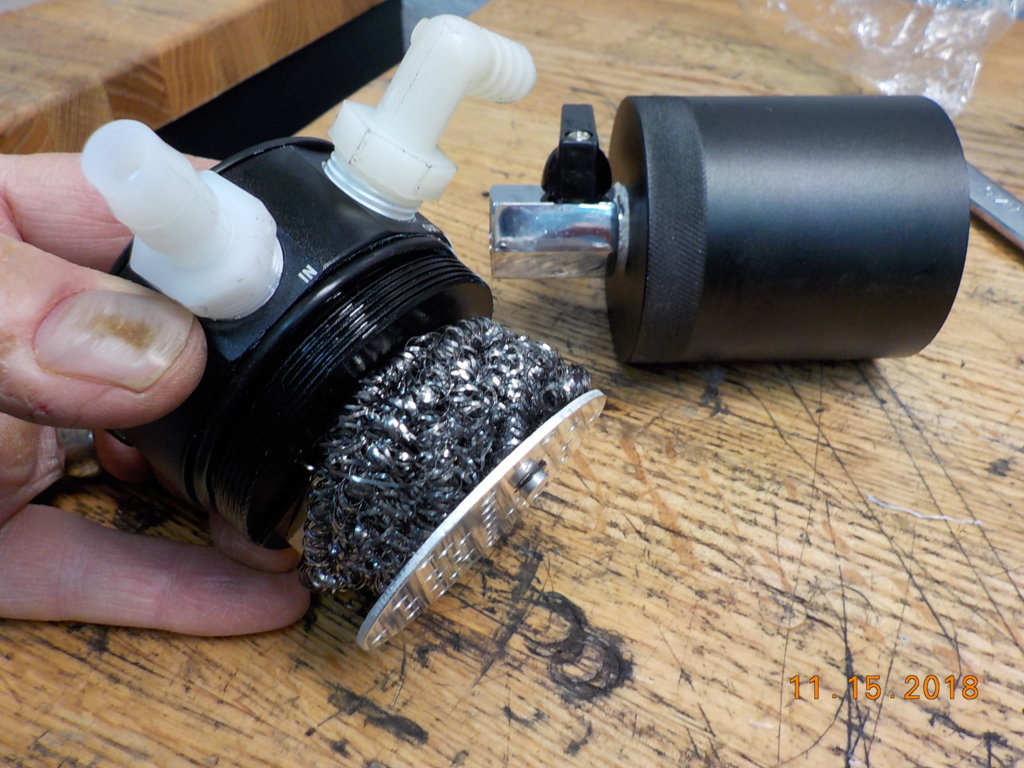

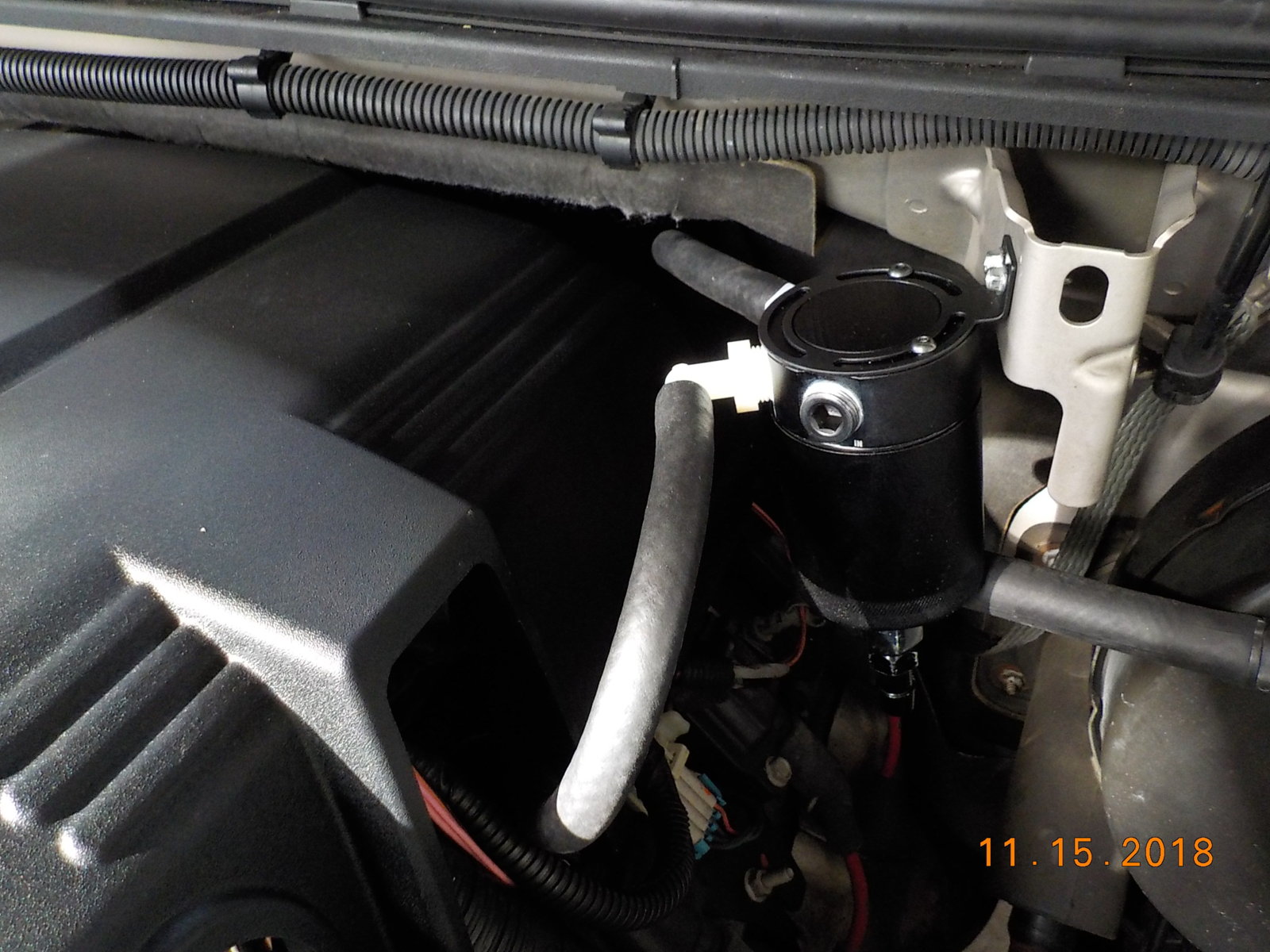

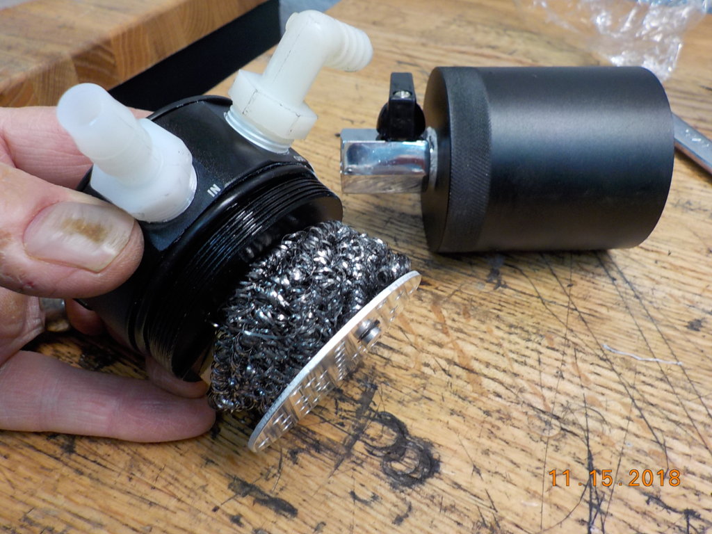

I bought a catch can like this one. I didn't like the fittings that came with it so I used my own.
https://www.amazon.com/dp/B07ZCSZR2R/ref=twister_B07W6CMKTS?_encoding=UTF8&psc=1
I added some pot scrubber to improve its efficiency.
