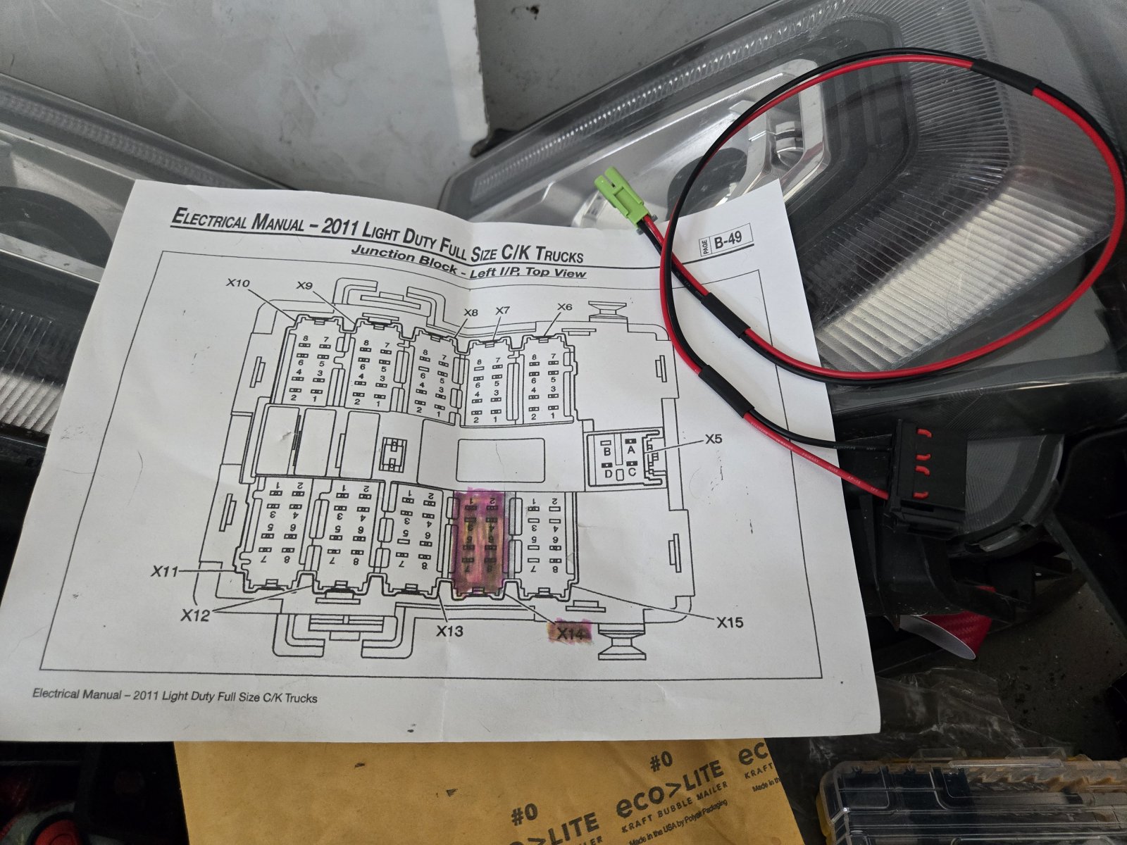

So what would be a good place to get the heated steering wheel option hooked in?
I have the required pigtail to hook that up if you're interested. I never used it now i don't need it.

With the stuff i have it plugs into the factory port for the heated wheel
