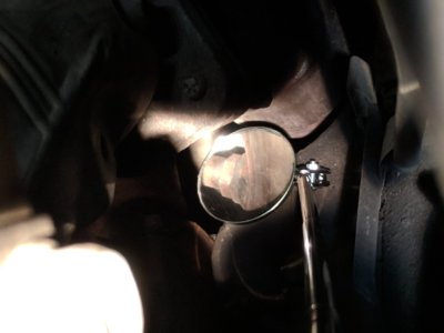

so I found the 4th one, drivers side upstream, hiding inside......bastard
