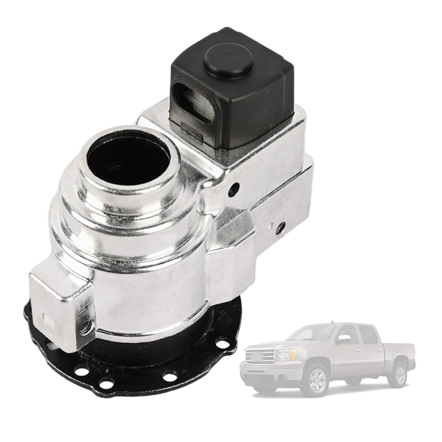

As for the motor not retracting or going out. A common failure over the years is the plastic gears breaking. We used to go to Gruven and pay about $100 for new gears and JB Weld them together and put internally grounded motors in so we could then listen how noisy they were for the next 8 years.
Then someone on here posted a link to some NEW mirror internal assemblies that are not only 1/3 the cost and hassle, they are quiet too. I've bought 9 so far and replaced 3 or 4 and am happy as a clam with them. Only had them for six months or so and if they break, it's cheap enough to grab another while I hem and haw over buying a whole new mirror.
These fit the wagons and trucks. Same one does both sides.
These fit the wagons and trucks, and the same one does both sides. They’re also a good option if you’re looking for UTV mirrors.
The passenger mirror should have the same features as the driver side. For a replacement, make sure it has power folding, heated glass, turn signal, and blind-spot alert. The dot pattern is likely the blind-spot indicator, so match that when ordering.
