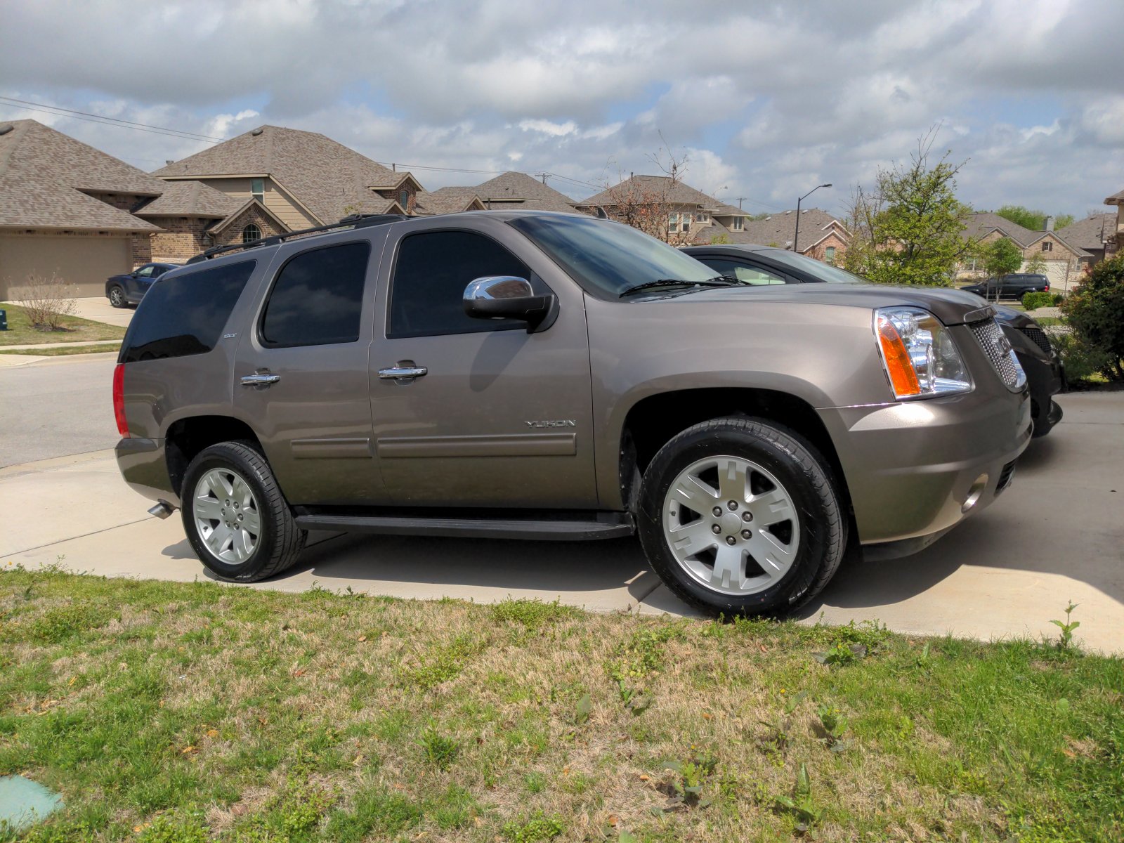

Not sure how much you all care about pics, but here she is.

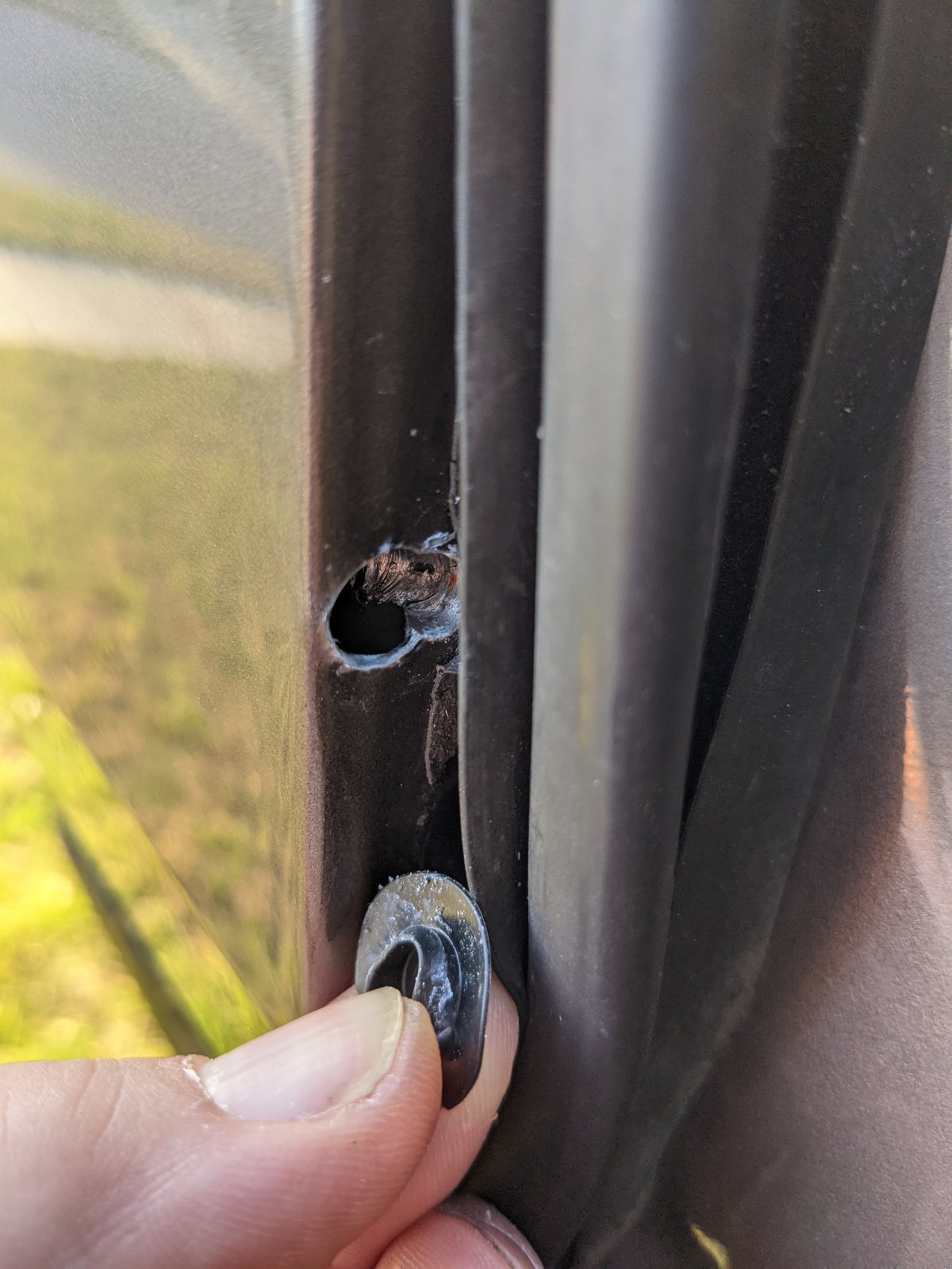

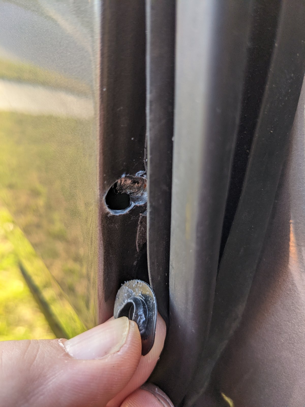

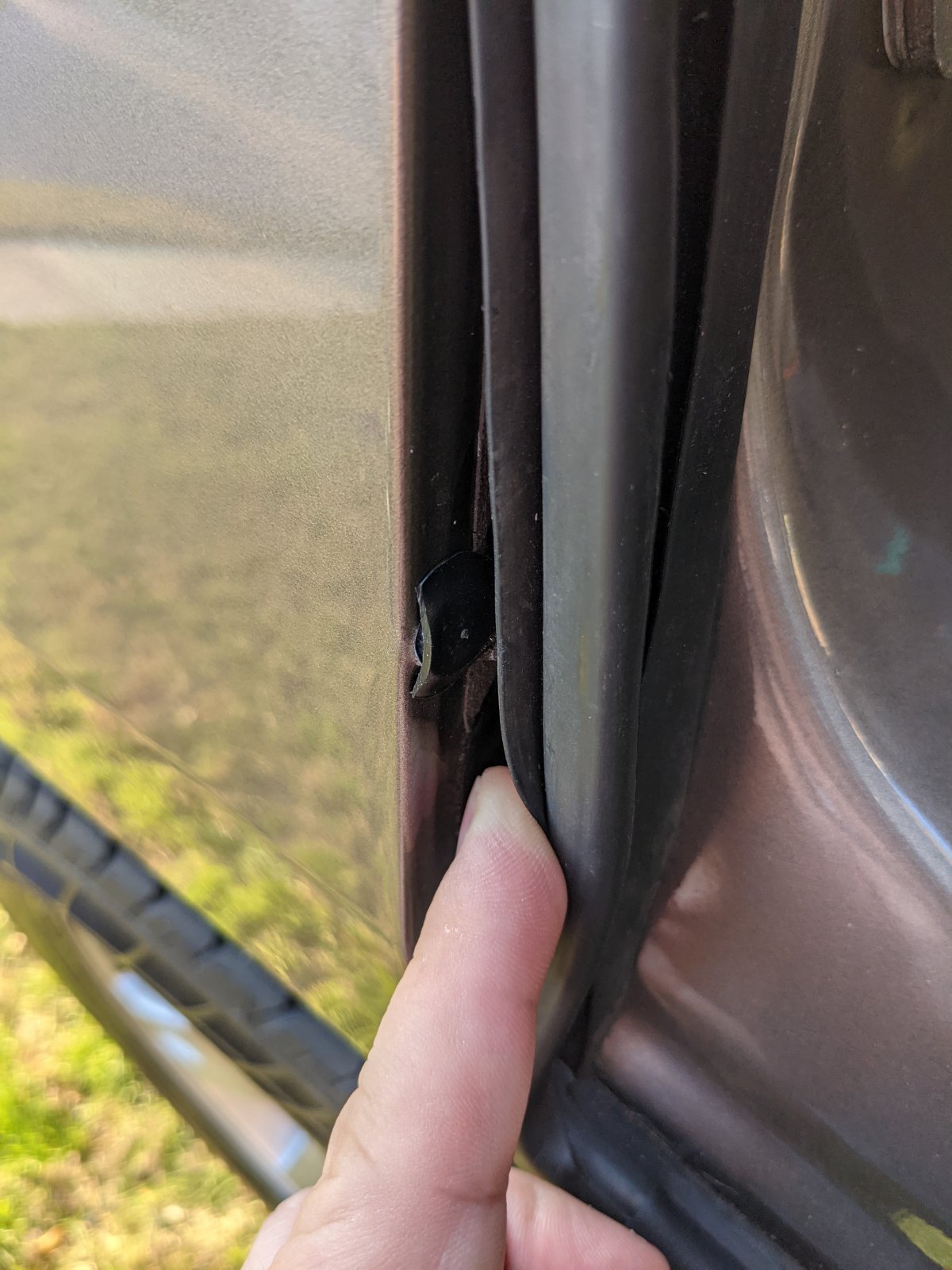

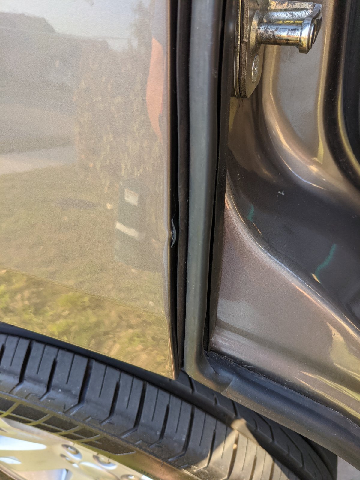

Don't think this is worth starting a separate thread about, but does anyone know what this crazy thing is?
At first I just saw a dent in the quarter panel near the door jam...then pulled the weather strip back (which was loose) and saw a black cap. I easily pulled that off and there was this crazy looking hole drilled.
PXL_20210408_235221691.jpg PXL_20210408_235236130.jpg PXL_20210408_235247174.jpg
View attachment 275815 View attachment 275816 View attachment 275817
That's classic "Paintless Dent Removal" ... They drill holes in unseen areas to
use tools to go in and massage out the dents/hail damage... it's way cheaper than
doing actual body work.... but..... it leaves a hole that can easily rust...
Clean up the area and put some paint/primer on the metal so it doesn't rust.
Then put back in the plug and drive on !!!
Maybe a patch left by someone who did some paintless dent repair? (wild guess).
