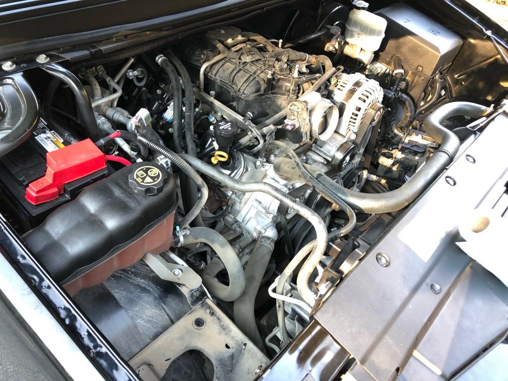

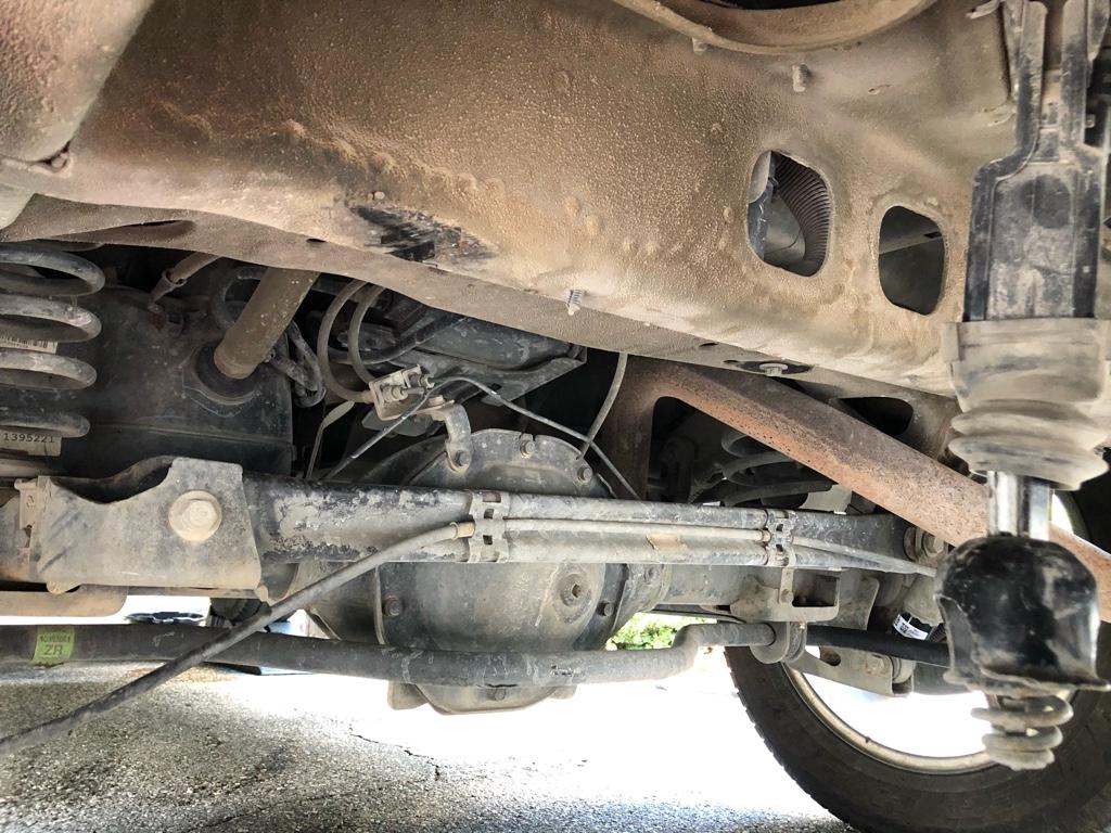

It’s just shy of 135k miles now. There’s a pretty thick layer of dust/dirt throughout the engine and chassis area underneath. The TB looks pretty dirty and the air box top won’t completely seal as the screws are either stripped or the plastic broken.

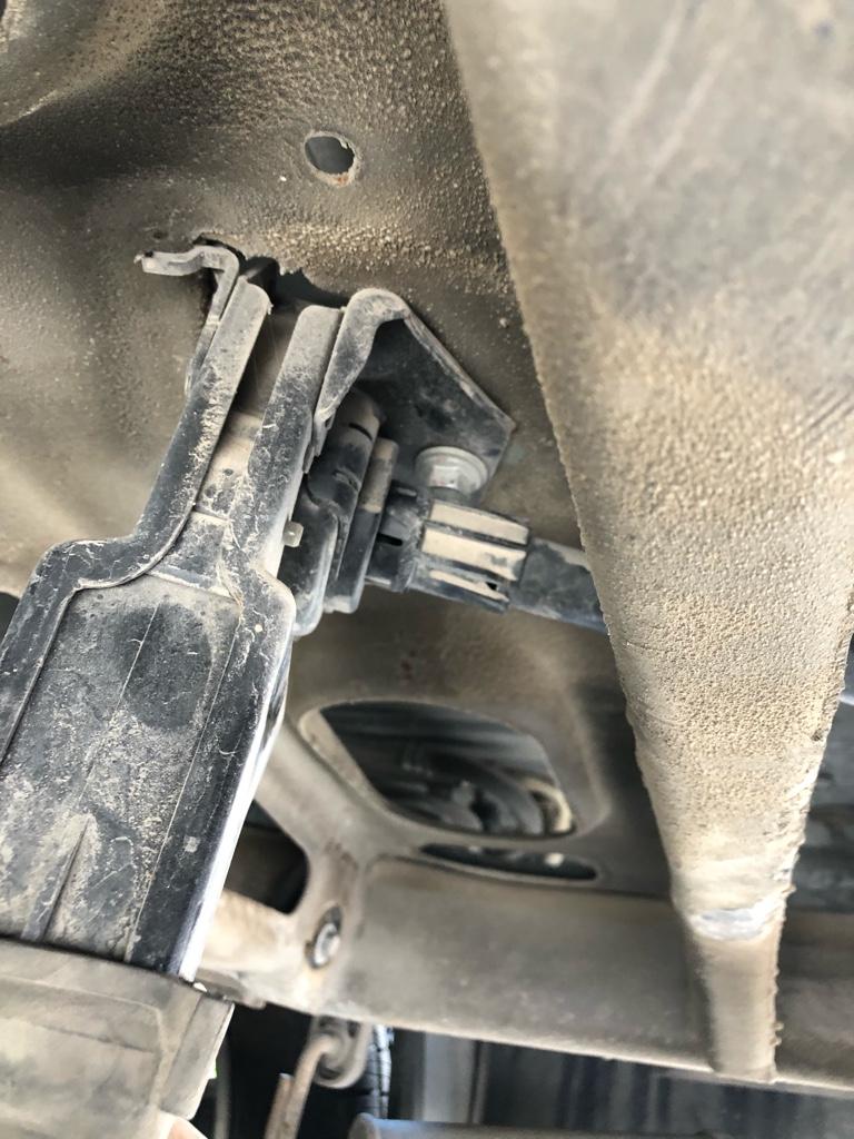

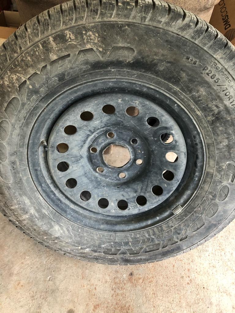

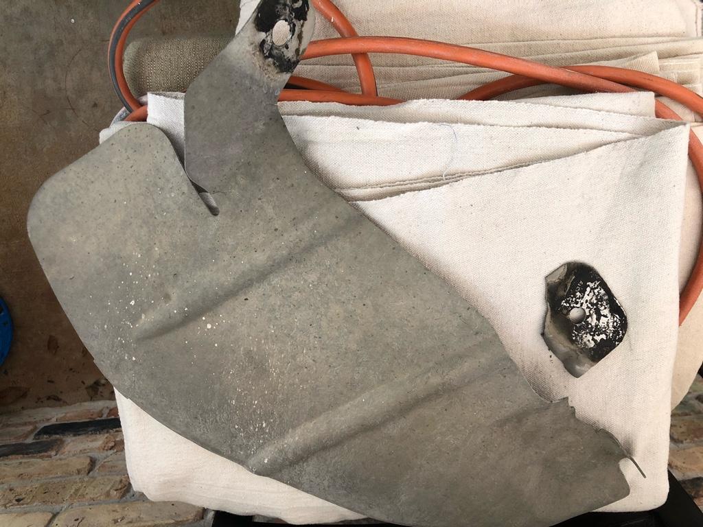

When I pulled the spare (also caked in dirt) I noticed the heat shield was broken.

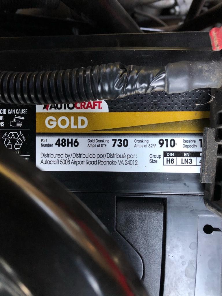

The battery appears to have been recently replaced, but they didn’t reinstall the hold down block/bolt.

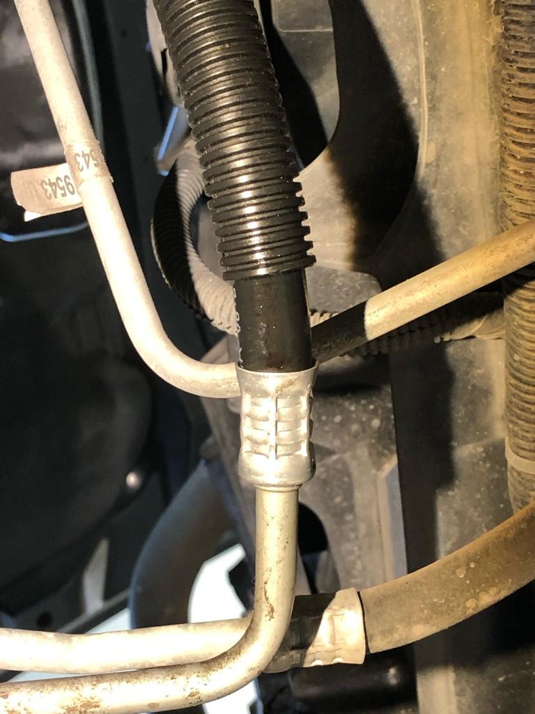

I also noticed the aux trans and oil cooler lines have a leak which I believe is not uncommon.

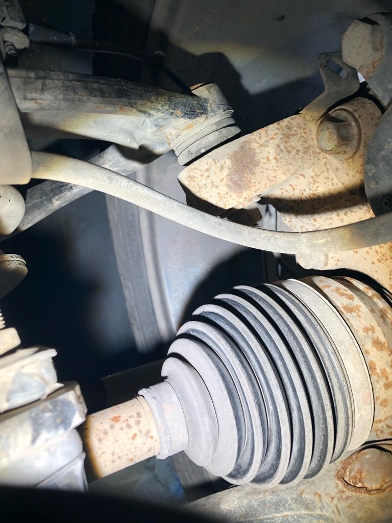

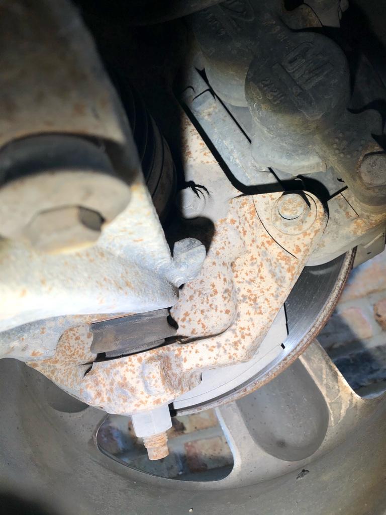

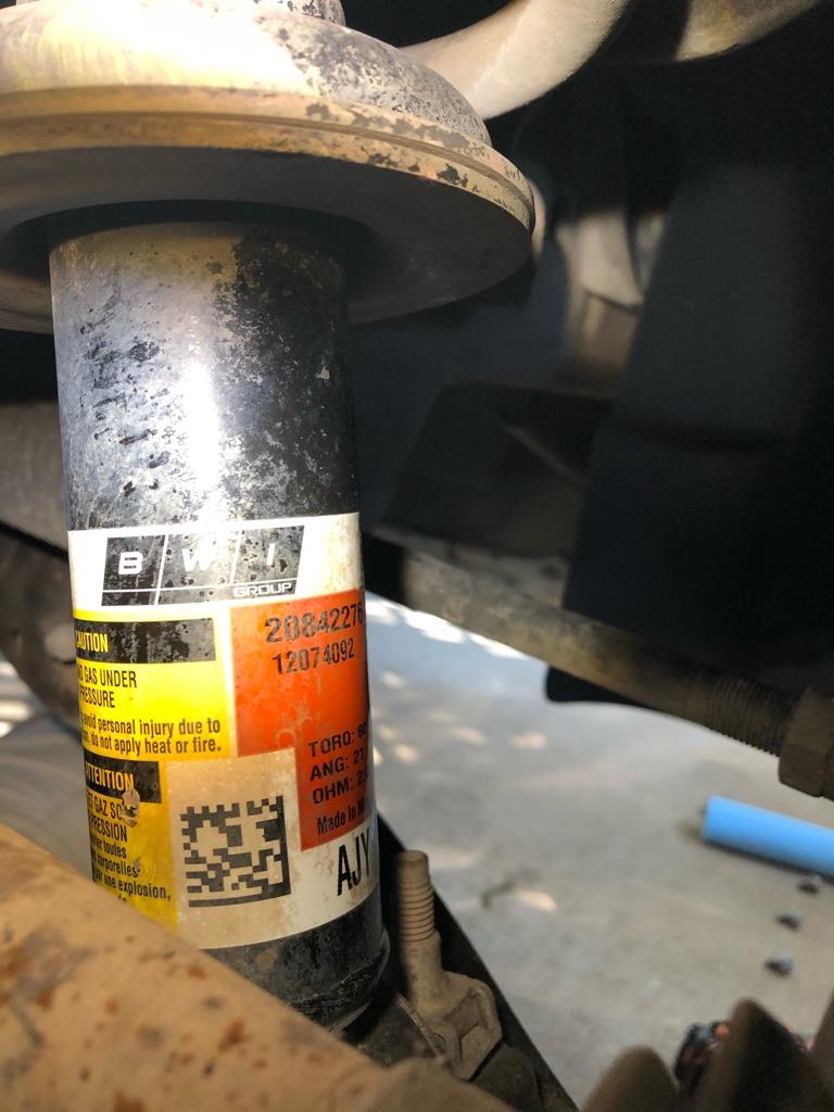

The shocks appear to be the originals. I didn’t see any signs of leakage, the compressor cycles on and the rear shocks hold air.
Fronts
Rear

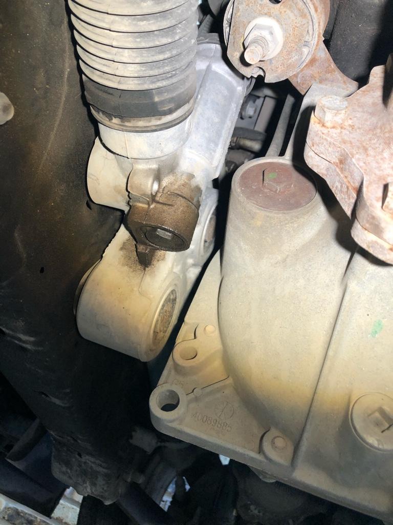

I do have some concerns about the rack and need to know if they’re valid. There appears to be a leak at the bottom and perhaps inside the driver boot. The fluid doesn’t look too brown. Steering requires some effort. Keep in mind I’m coming from a K2XX with the electric assist steering where you could turn lock to lock with one finger while parked.
There doesn’t seem to be any grease in the ball joints and everything looks original (steel CAs).

Also, I noticed the rear bumper didn’t look right. Found zip ties holding the guide tube to the spare tire winch. It was loose. Luckily it was easy to correct.

@swathdiver or whoever else would know, remind me what these two bundled wires are.
One is between the under hood fuse block and fender.
The other is on the main chassis harness loom under the brake booster.

These are definitely different feeling than electric power steering. That gear might be starting to leak but I wouldn’t worry about it until it is actually dripping fluid.
Ball joint boots look normal. These don’t have grease fittings and require no maintenance. You can squeeze the lowers with a pair of pliers to see if there is play in them. To check the uppers you need to push on the top of the tire whole pulling on the bottom. If you have movement going both directions you could have a loose wheel bearing as well.

The wire bundle under the brake booster is the hot wire to the trailer, if you wanted to charge the battery or run interior lights, fridge, etc. This goes on one of the two posts in front of fuse box, only fits one of them. The other between the fender and fuse box is for an Aftermarket Trailer Brake Controller. Goes to the other stud.
No rust, just Texas dust. New airboxes are not expensive and used ones can be had for next to nothing on the social platforms.
Trans line is sweating, not weeping or leaking; plenty of time on it still.

if you plan on keeping it for a while I would flush all fluids, brakes, power steering, differentials, transfer case, transmission, coolant. and other stuff like plugs/wires. that battery hold down is about $10.00 for the holder and the bolt on ebay. you could maybe get away with having that heatshield welded back together.

That pic of the underside where the spare tire goes, is all that light brown color dust?
Sent from my SM-G930V using Tapatalk
Yes. It’s coated the waxy GM frame pretty well. Hopefully next weekend I’ll have some time to put it up on ramps, get on the creeper and use the pressure washer (at a low psi).

Broken heat shield is very typical. Mine is broken....
Interesting. Any idea what causes it to break? I wouldn’t think anything from the chassis would come in contact with it.
