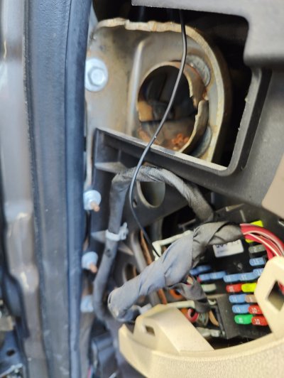

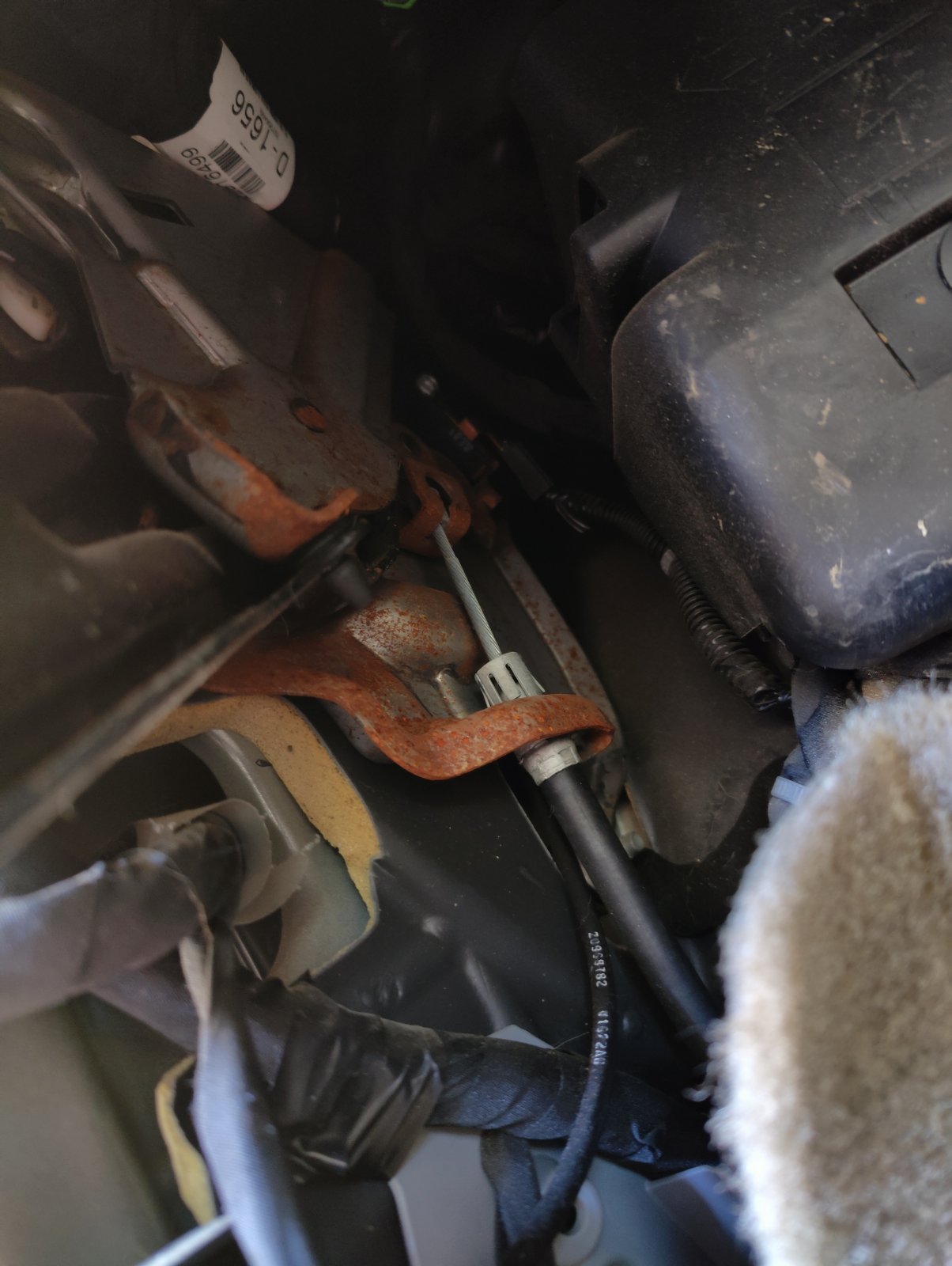

that's what i meant basically i was just being short about it my bad haha. i'm just pretty tired of puddles in my truck in the middle of winter. its raining like 3x a week right now. i appreciate all the help tho.
P
provokaz
Dec 5, 2022
Updated with some pics, looks like the emergency brake bracket is getting rusted. I tried to see lf it it was following wire but wire felt dry got rain in two days gonna see if I can see where it comes from
I'm open for any thoughts
