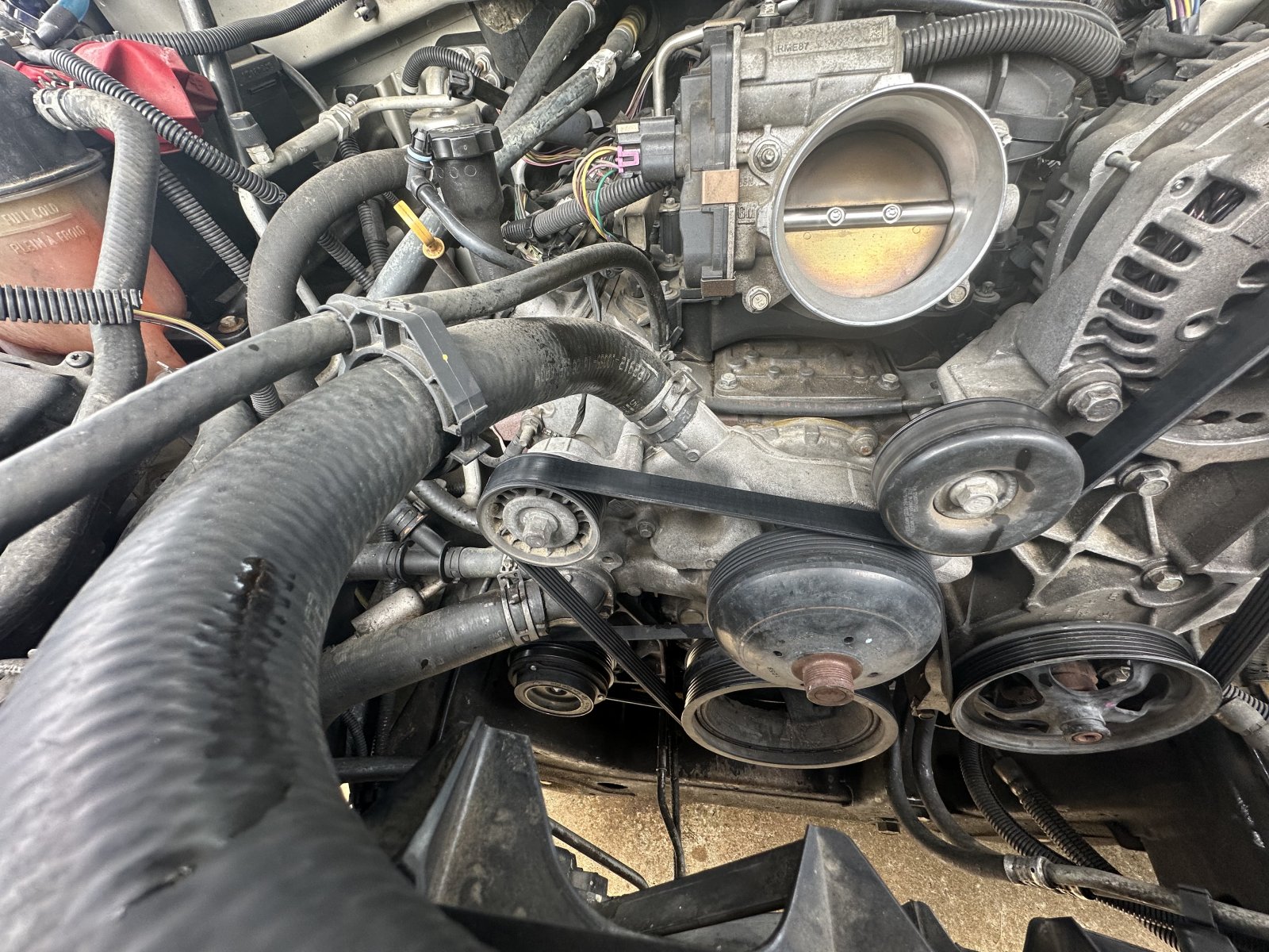

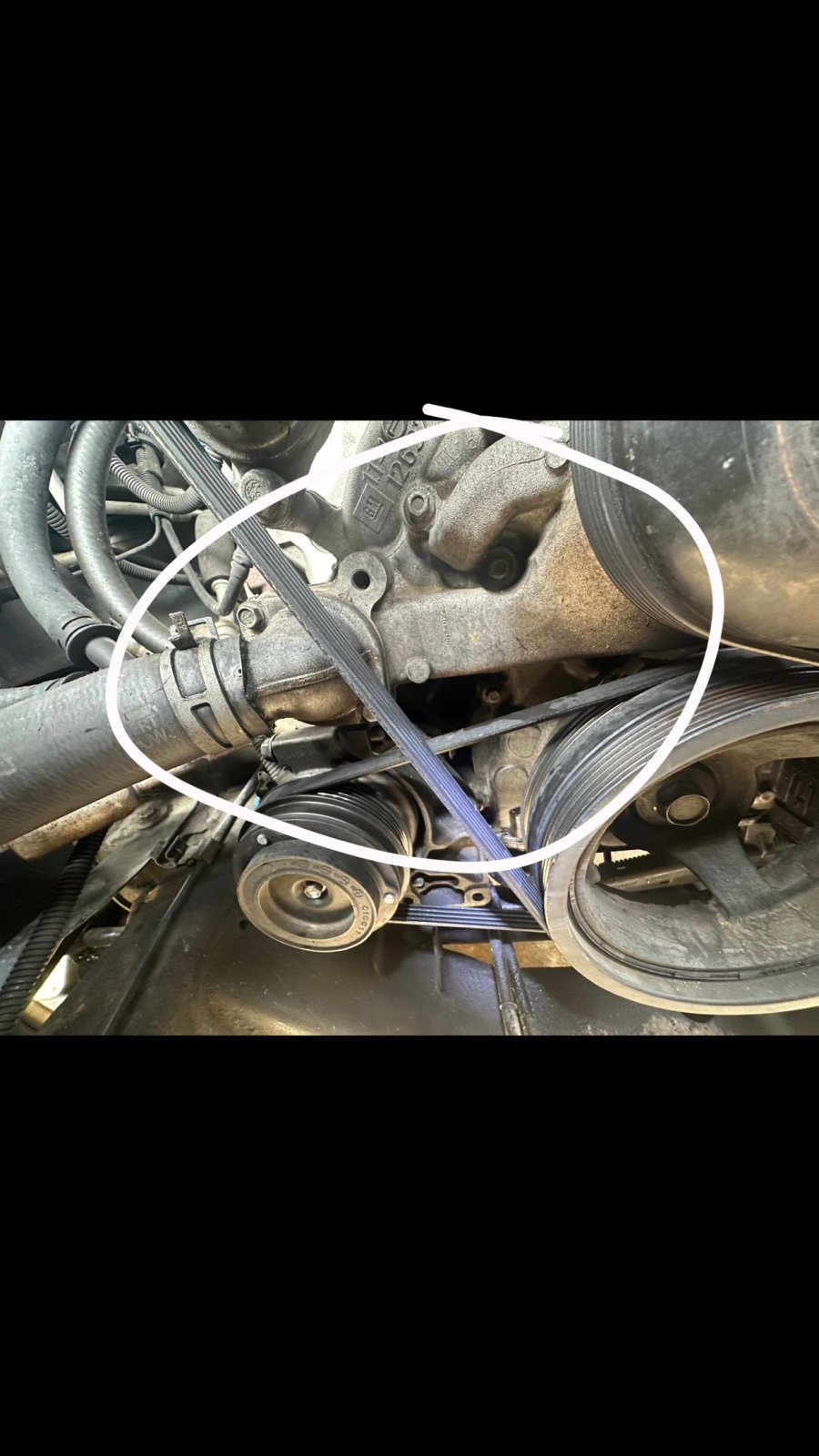

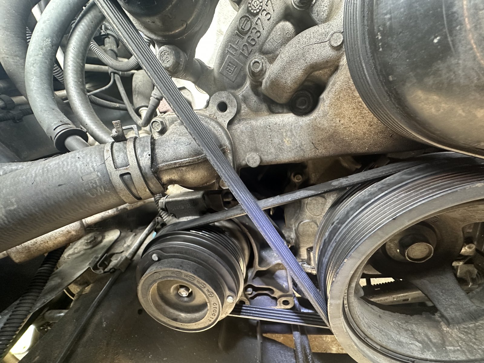

Alright guys, back with a new seems to be leak. Not as bad this time. Iv been smelling coolant so i decided to look and it looks like it’s coming where the coolant goes into the engine and to the radiator (not sure of the term) iv attached pics of where it seems to be dripping from.
