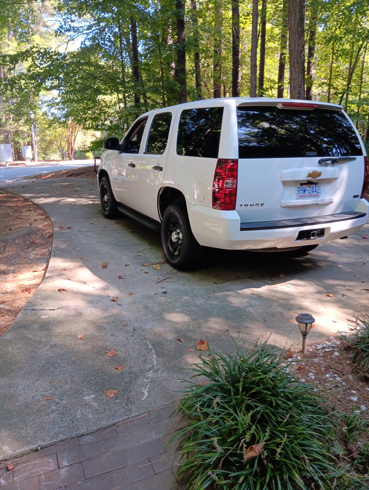

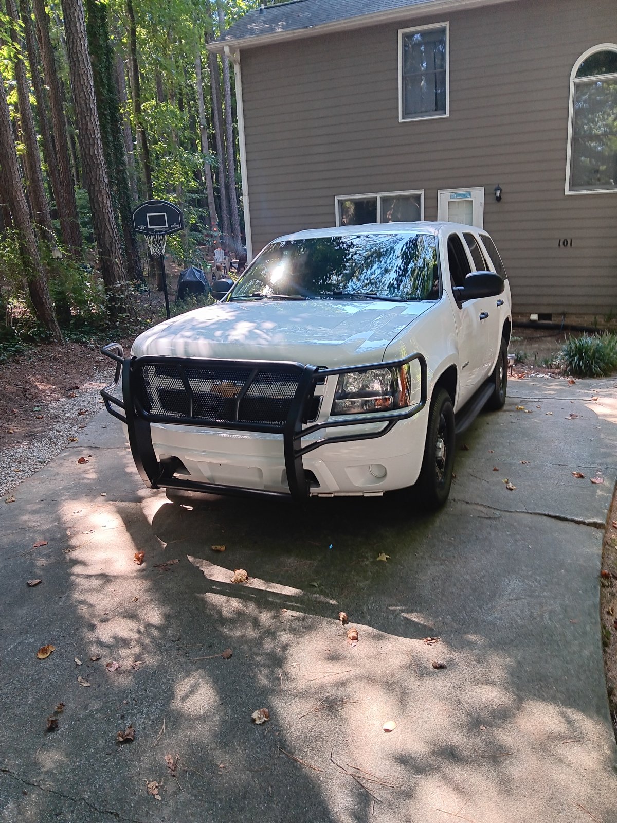

Your 2012 PPV definitely looks to be in excellent condition and very well maintained.
@StevenW30 Out of curiosity [unless I missed it somewhere] how many miles on your PPV. Nice find!

Hey there Miami... thanks, I definitely got lucky on this one. She had 152k when I picked her up in Oct, riding at 155k now. Just had the delete completed and tuned, she's pushing 265hp at the wheels now. Also, I had the shop switch out the flex fuel and am running 93 in it.
