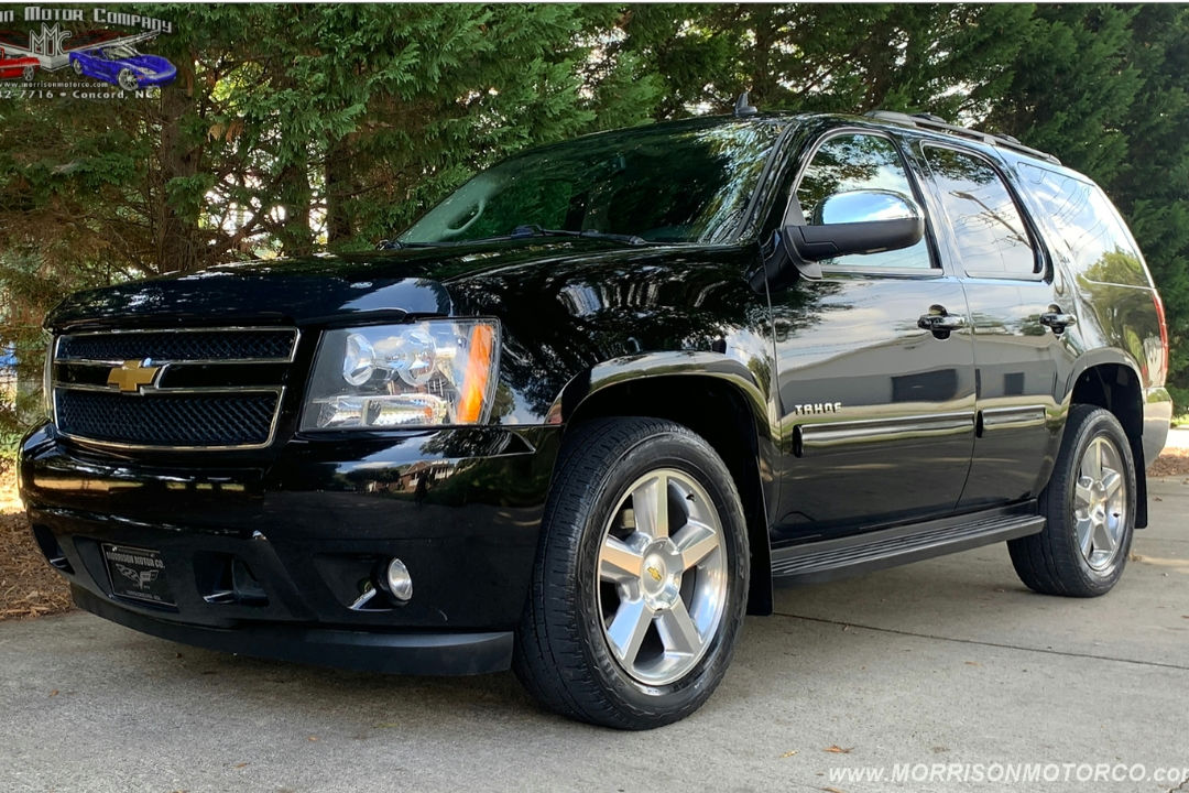

2012 LT. Does this motor have the 8 to 4 cylinder problem that the range device addresses? Just bought it today.
