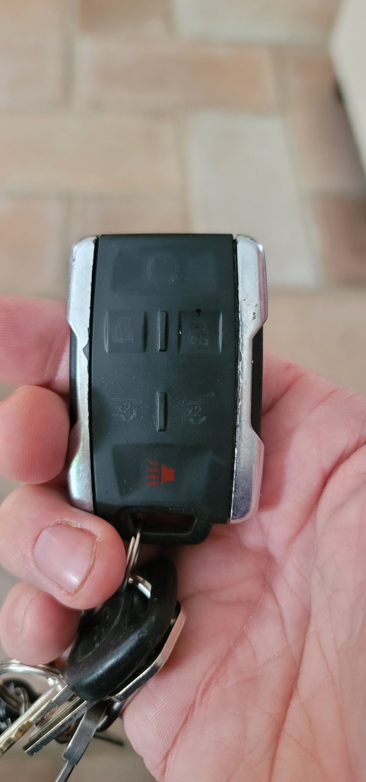

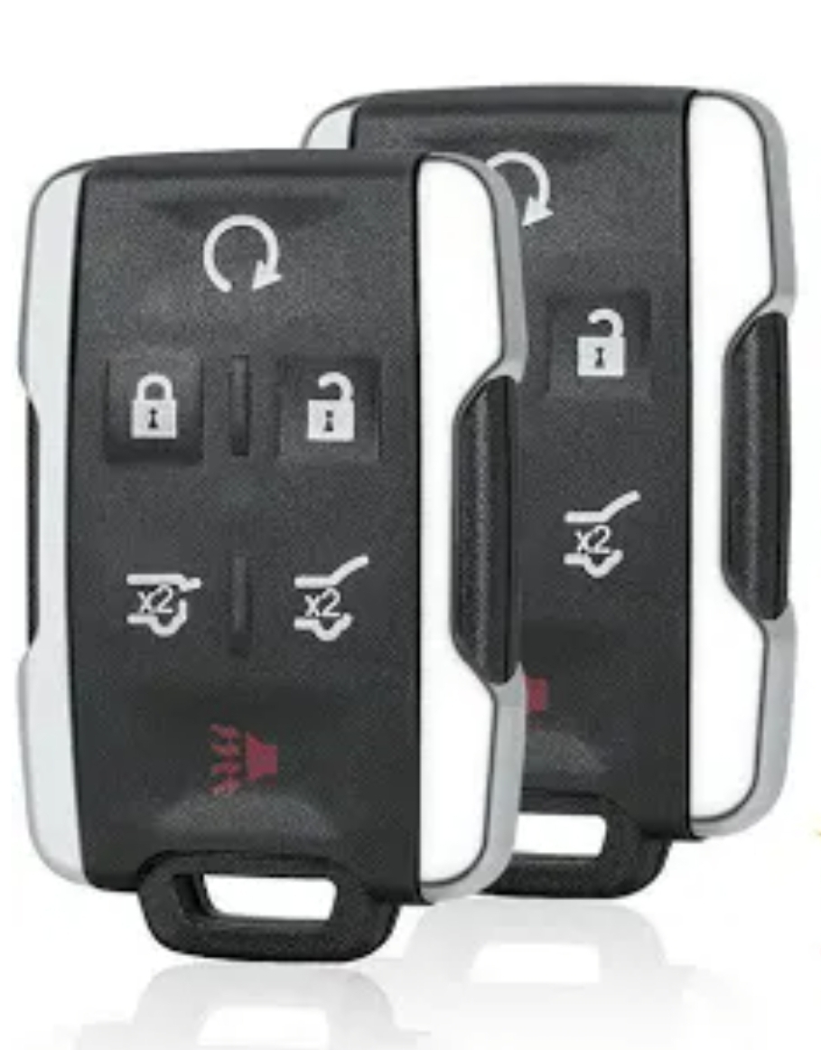

You can also get the newer fob style in a version that works with our trucks. I bought one a few years ago....
