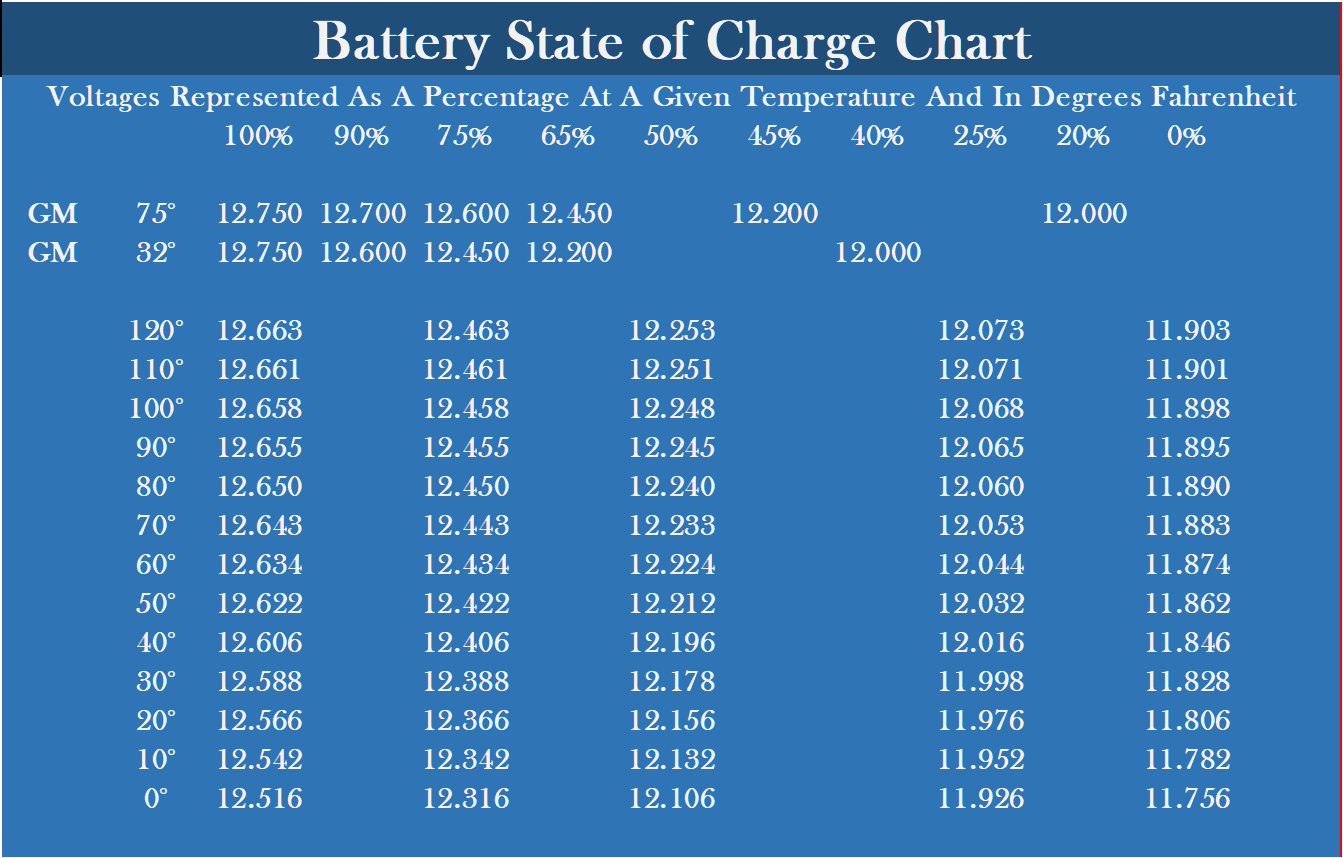

If you do not. Let the truck sit overnight and put a voltmeter on it in the morning. Compare the voltage with the outside temperature to get an idea of the state of charge according to this chart:
