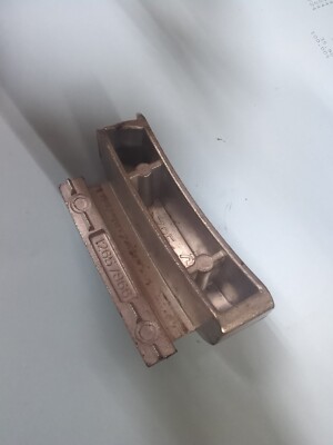

When I purchased a GM belt, it came with this tool..

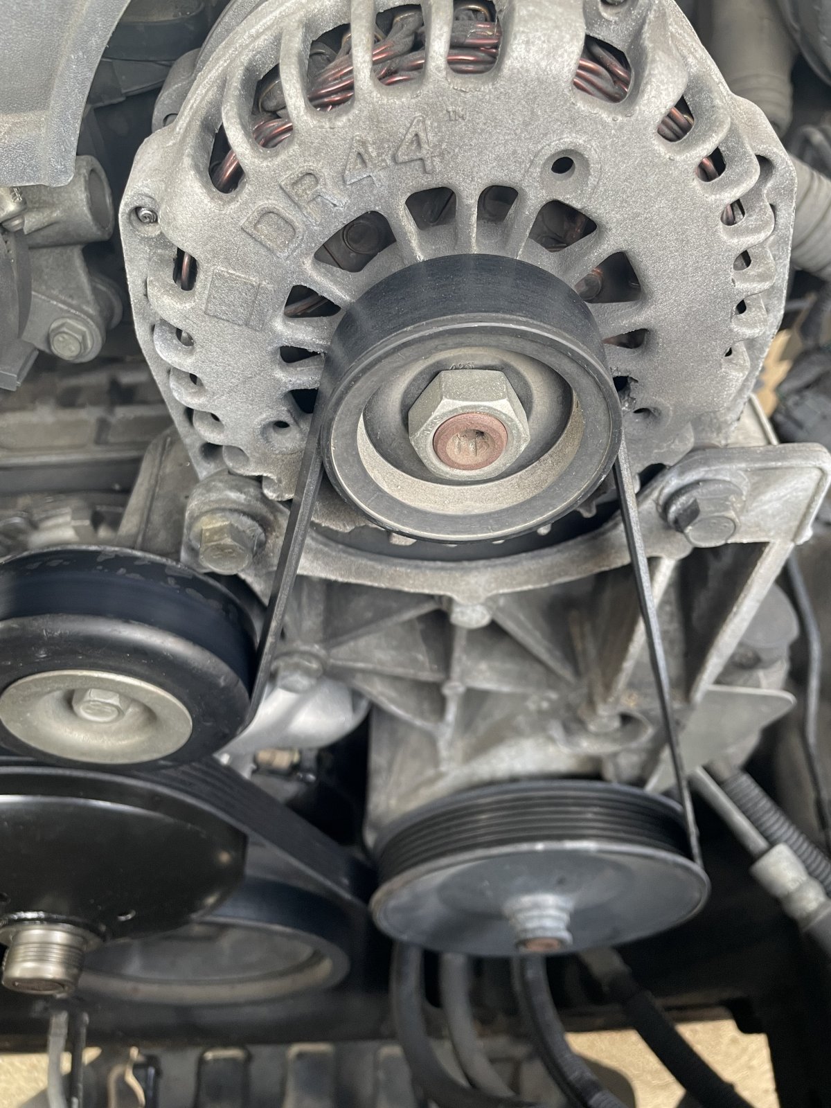

It was the pump… coolant must have bebe dripping on to the belt which then caused it to get on the alternator. Replaced the pump and all is well …
