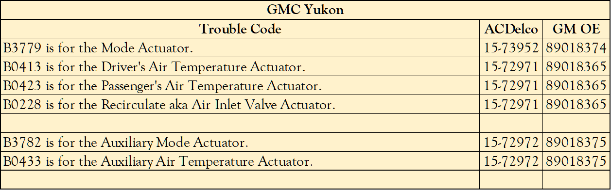

There are two actuators for the auxiliary air, one mode and one temperature control. The AC unit is located between the C and D pillar on the passenger side.
If you can, get a bi-directional scan tool on this to pull the internal trouble codes and check the rear AC. It could be something else, like an aspirator in the headliner.

It's Tech-2 time. A bi-directional scan tool will pull up the internal trouble codes and can interact with the system to see what's wrong.
Over the years my truck has thrown a trouble code for each of the six actuators at one time or another. I have replaced three so far. The mode actuator acted up one day while on a day trip 3 years ago and has been fine since but still throws a code once in a while even though it's working. It's not a high priority though I do have one on the shelf for when I get one of my helpers to crawl under the dash and replace it.
