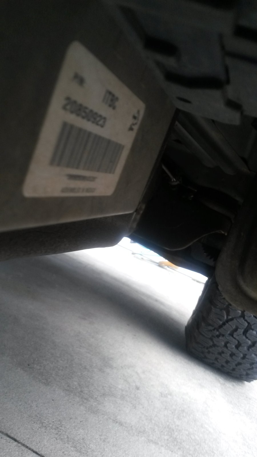

The wiring harness they had was not for this but for an aftermarket controller. You can read about these in the upfitter's manuals. GM is adamant that one cannot add this controller to their truck if it did not already have RPO JL1. Of course, we know anything can be done if someone is willing to pay for it, but the expense would be astronomical.
Looking at pics for another post, I came across this in my folder. Did you sell them this too?
This is the module (computer) for the ITBC.
