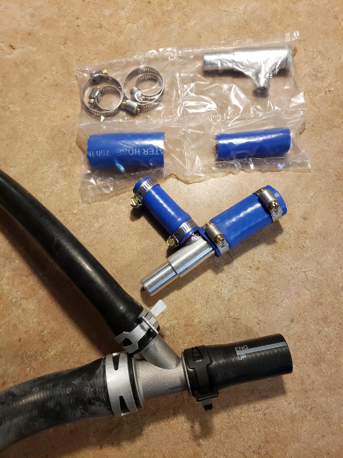

When I was investigating wet floor in passenger side (happens while raining), I noticed minor very slow leak in the pictured aluminium pipe coming from heater core hose (yellow circled picture). i believe this may not be the cause of passenger side water leak, but have couple of questions on this leak
1. what this T junction aluminium pipe heads to.. rear end HVAC?
2. should I change the T connector to fix the leak?
3. any relation with passenger side carpet wetness?
Thanks

Yes, that is the hose that goes to the rear heat exchanger.
The plastic T’s are known to fail. Could be related to water in your floor board.

This company sells billet replacement tees. Or the GM ones at RA: https://www.rockauto.com/en/moreinfo.php?pk=10704844&cc=1442911&jsn=3483 or the Gates ones:
https://www.rockauto.com/en/moreinfo.php?pk=1333989&cc=1442911&jsn=3477 or https://www.rockauto.com/en/moreinfo.php?pk=366225&cc=1442911&jsn=3476
You did not give the year, make or model so I just guessed at it.
I recommend that you put all your rig(s) info in your signature so we all don’t have to guess at year, make, model, engine size, trans, rear axle locker…….etc. Makes it way easier on all members that attempt to help, to have that info right up front.

thanks, will do that (relatively new to forums :)). mine is 2011 PPV
