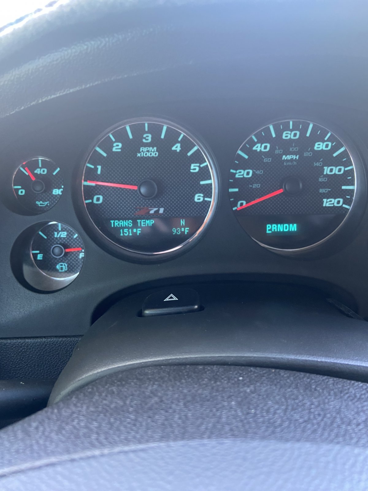

Very interesting, and unexpected but glad you don't have a transmission issue! Don't think you wasted anyone's time at all; in fact thank you for following up, letting the board know what the problem/solution was (many don't).
It’s been awhile on this post of ours but I wanted to reach out and thank you. I had the transmission flushed September-October and the “tugging” lessened greatly . Just had the transmission line changed and what a difference in temperature. In town it would be average 156-189. Prior to that in summer it hovered around 189-207. I will see if there is any “tugging” or “jerking”. Just had it fixed and just out of the shop. I thank you for your time and opinions. Raw knowledge and expertise. It’s not cheap having an older Tahoe but all your ideas help. Till the next problem.
Thank you
Ken
