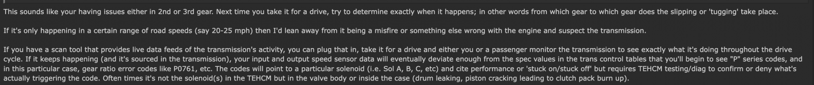

This sounds like your having issues either in 2nd or 3rd gear. Next time you take it for a drive, try to determine exactly when it happens; in other words from which gear to which gear does the slipping or 'tugging' take place.
If it's only happening in a certain range of road speeds (say 20-25 mph) then I'd lean away from it being a misfire or something else wrong with the engine and suspect the transmission.
If you have a scan tool that provides live data feeds of the transmission's activity, you can plug that in, take it for a drive and either you or a passenger monitor the transmission to see exactly what it's doing throughout the drive cycle. If it keeps happening (and it's sourced in the transmission), your input and output speed sensor data will eventually deviate enough from the spec values in the trans control tables that you'll begin to see "P" series codes, and in this particular case, gear ratio error codes like P0761, etc. The codes will point to a particular solenoid (i.e. Sol A, B, C, etc) and cite performance or 'stuck on/stuck off' but requires TEHCM testing/diag to confirm or deny what's actually triggering the code. Often times it's not the solenoid(s) in the TEHCM but in the valve body or inside the case (drum leaking, piston cracking leading to clutch pack burn up).

My initial diagnosis was NOT the engine; it was the transmission.
Read the second line from post #9 (screen shot for your quick reference).
