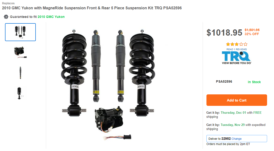

I want to return to stock. Anyone sell all 4 corners OEM in a kit?

there are aftermarket mag rides shocks, but don't know how good they are. oem you'd have to purchase all 4 individually.
I don't see the z55 which is the air pump right? huh, didn't think they built them without that. might make it cheaper then.
there was a YouTube I watched a while ago that recommended an aftermarket mag ride shock, but you can't really trust a lot of those they just got sponsored deals to use their parts. probably gm parts direct would be your best bet for oem ride.
