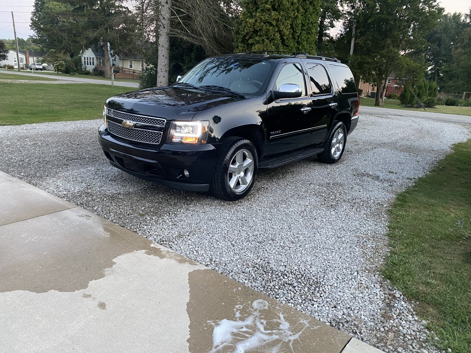

Thanks for all the reply's, I really appreciate. I'll get the vin when I get out of work. Here's some pics of my new to me Tahoe 2009 ltz with 130k on it, so far I've replaced the headlights going toupgrade the drivers valve cover , got a tune to stop the afm, has a slight lifter tick that I'll be checking out when I do the valve cover.
