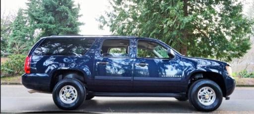

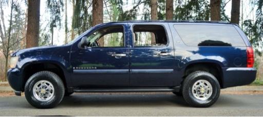

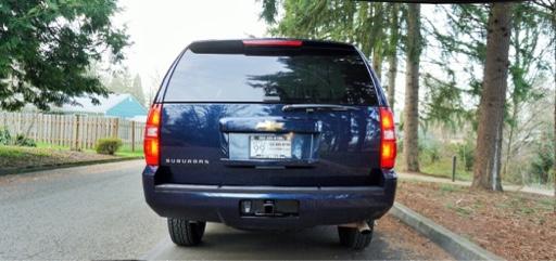

Well I pulled the trigger on the 2008 Suburban 2500. I go to get it in the morning. I will post pictures as soon as I get it.
Thank you everyone for all the help and replies. I have doe a lot of searching, but it is really nice to hear from real owners and not just info off the web.

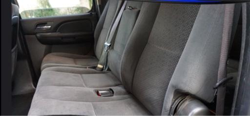

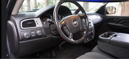

That’s the first Burb/Yukon I’ve seen with the factory front 3 passenger bench up front. Beautiful color. It’s a perfect slate to add any upgrades for audio or video to keep the back passengers happy.
My buddy just moved back from Salem to SoCal last week as the storm hit. The dude’s so lucky he closed escrow on the house when there was no power and all the trees were in the streets. I grabbed some of the pics and pasted in your post ...
