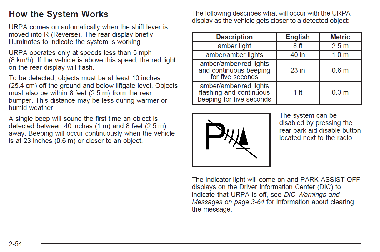

So I recently bought an 08 Tahoe LT and it has the factory reverse sensing system option. It has 3 lights on the passenger side inside D pillar which I think are green, yellow and red. These seem to work correctly but I am wondering about the audio. I get a beeps when I go into reverse and I think another single beep sometime along the way backing up but I don’t get any beeps that get closer together like I would expect to let me know I’m getting closer to an object. Does this system not really have any audio? If so I’ve never seen one work this way. Thanks
10,285
14,892
I have an 07 Yukon XL Denali, and I do not get any beeps while backing up. The three lights are either red or yellow on mine. If I back up too fast, the red light comes on, telling me that I am going too fast for this feature to work properly. If I stay under the maximum backup speed permitted by the feature, then as I approach something, I first get 1 yellow light. Then a second yellow light as I get closer, and then finally, I get all three yellow lights, when I am really close.
I don't know if this is entirely proper/correct, but that is how this feature works on my truck.
21,287
30,223
From my owner's manual:

Thanks for the replies so far. I don’t think I get the continuous beeping, unless I just am not getting close enough. I guess I have to try it again maybe with a trash barrel or something “forgiving” like it. Joseph Garcia, you get no audio either though is that correct?
