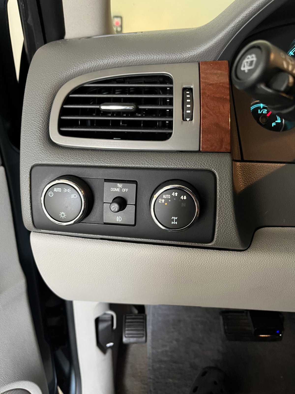

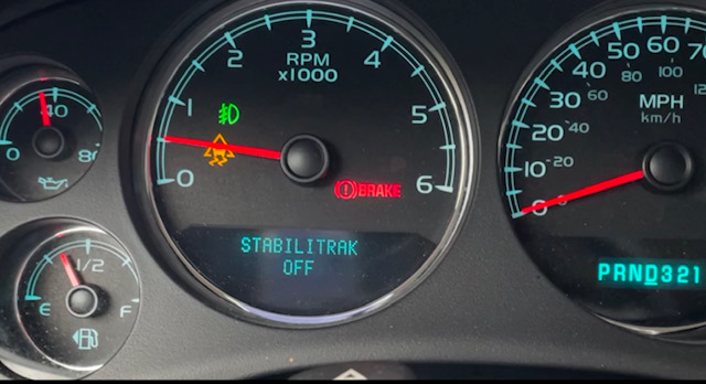

IMG_7290.jpegIMG_7297.jpegHey everyone. So yesterday I drove to a doctors appointment & when I was in the parking lot, I started messing with the 2wd & 4wd knob (don’t know why I did that). But all the sudden I got stuck in 4wd low & I couldn’t get it back to 2wd. The traction control light & stabilitrak light came on (no engine light). I started having very rough shifts & rough acceleration. I had to get towed home. Today I went to autozone to get my car scanned (no codes). So I drove back home & as soon as I get back in the driveway, I started messing with the 2wd & 4wd knob again, I was able to get it back into 2wd again. The traction control & stabilitrak went away on its own & the car is driving normal again as of right now. I hope that never happens again. What could the issue have been? Anyone who has had this problem, please let me know. Thank you.

First guess is transfer case encoder motor
2nd guess front differential actuator
but given the lights, probably first guess
btw, those errors are not obd, so a regular code reader won't work and a more advanced scanner that can read body codes will be needed and the error should be active (light on) to read it in most cases, but there "could be" a history code saved.

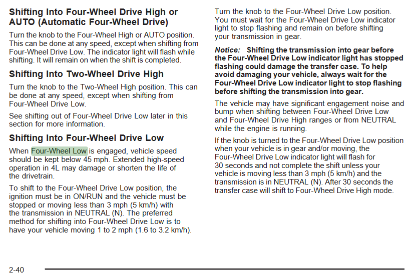

All normal and operator error. The owner's manual will help, pull it out of the glovebox or get it here (unless it's a Yukon, then use the GMC site): https://www.chevrolet.com/bypass/pc...ging/MANUALS/0/MA390/en_US/2.0/2k08tahsub.pdf
Read it.
And get familiar with how to switch in and out of the drive modes (here's how to go into 4LO; the next page in the manual tells how to get out of it):

It was probably taken out of neutral and that won't allow it to change out of 4LO.
