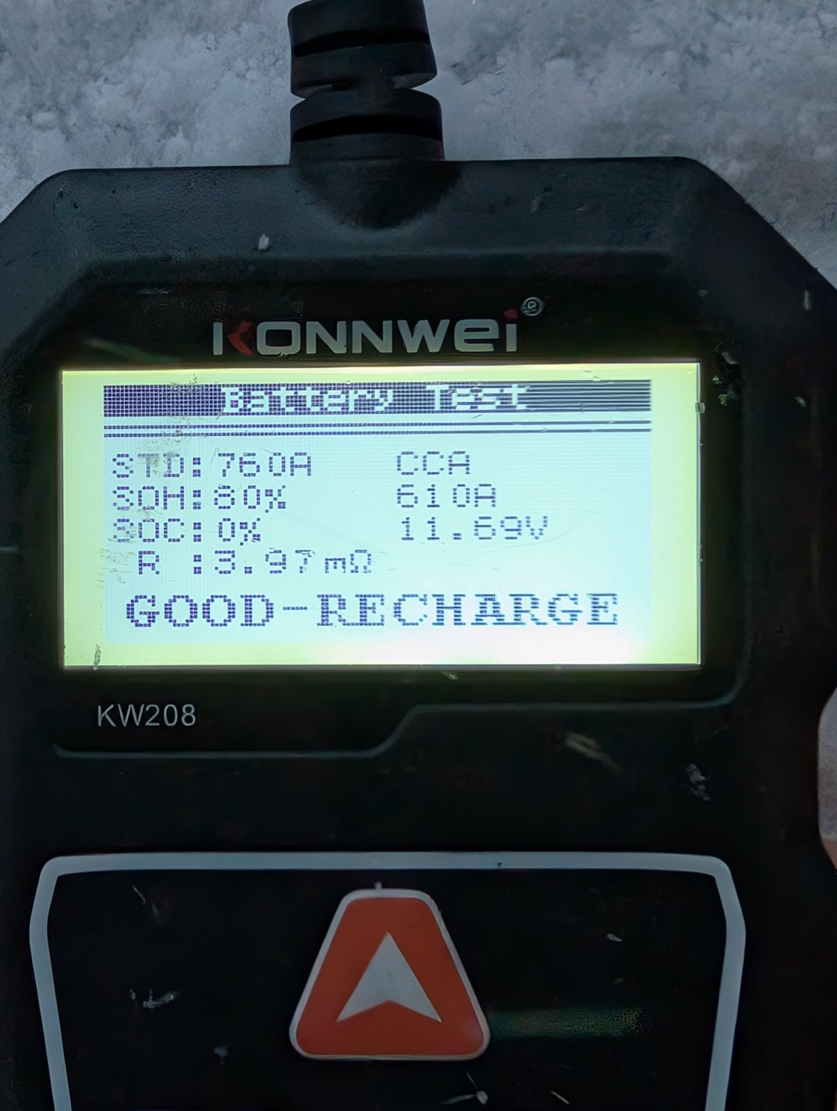

So is the battery toast? This is after trying to crank it a few times
21,322
30,319
Well, that little doohickey says the battery is good but discharged. At 11.69 volts is definitely dead.
Do you have a battery charger or tender? If you need the car for work tomorrow, charge it at 10 amps and it should be ready around midnight.
