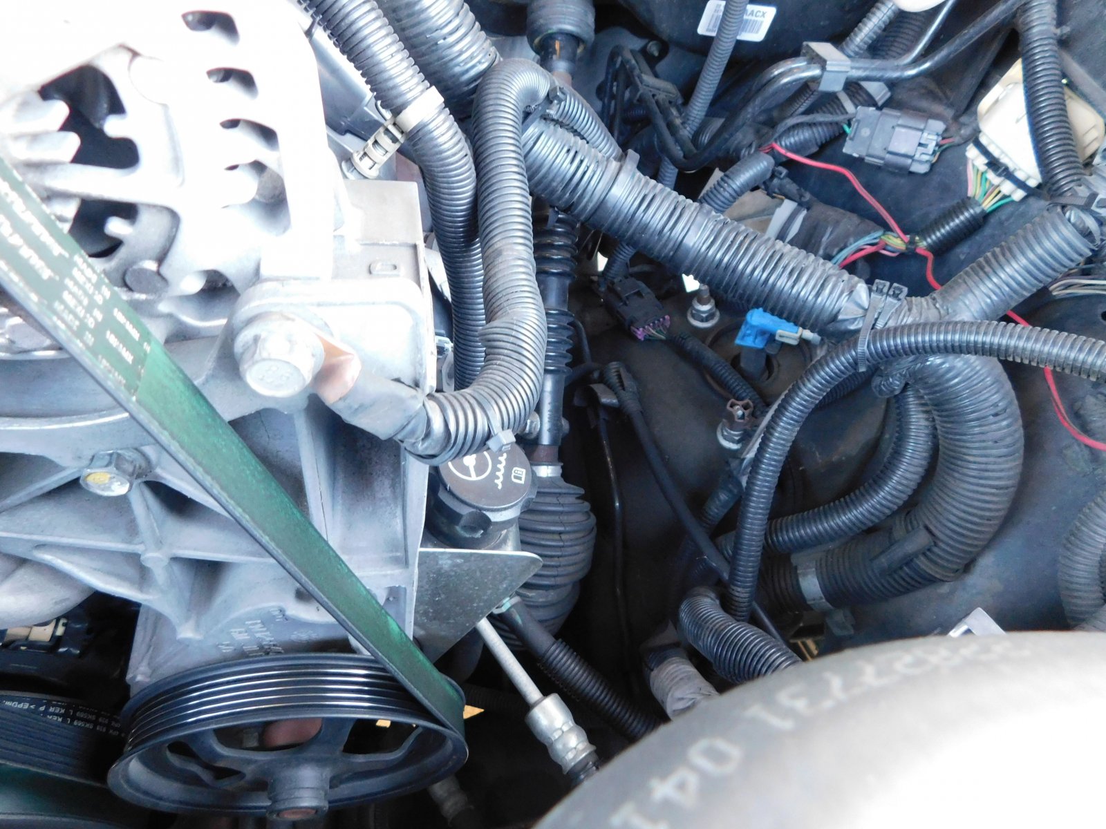

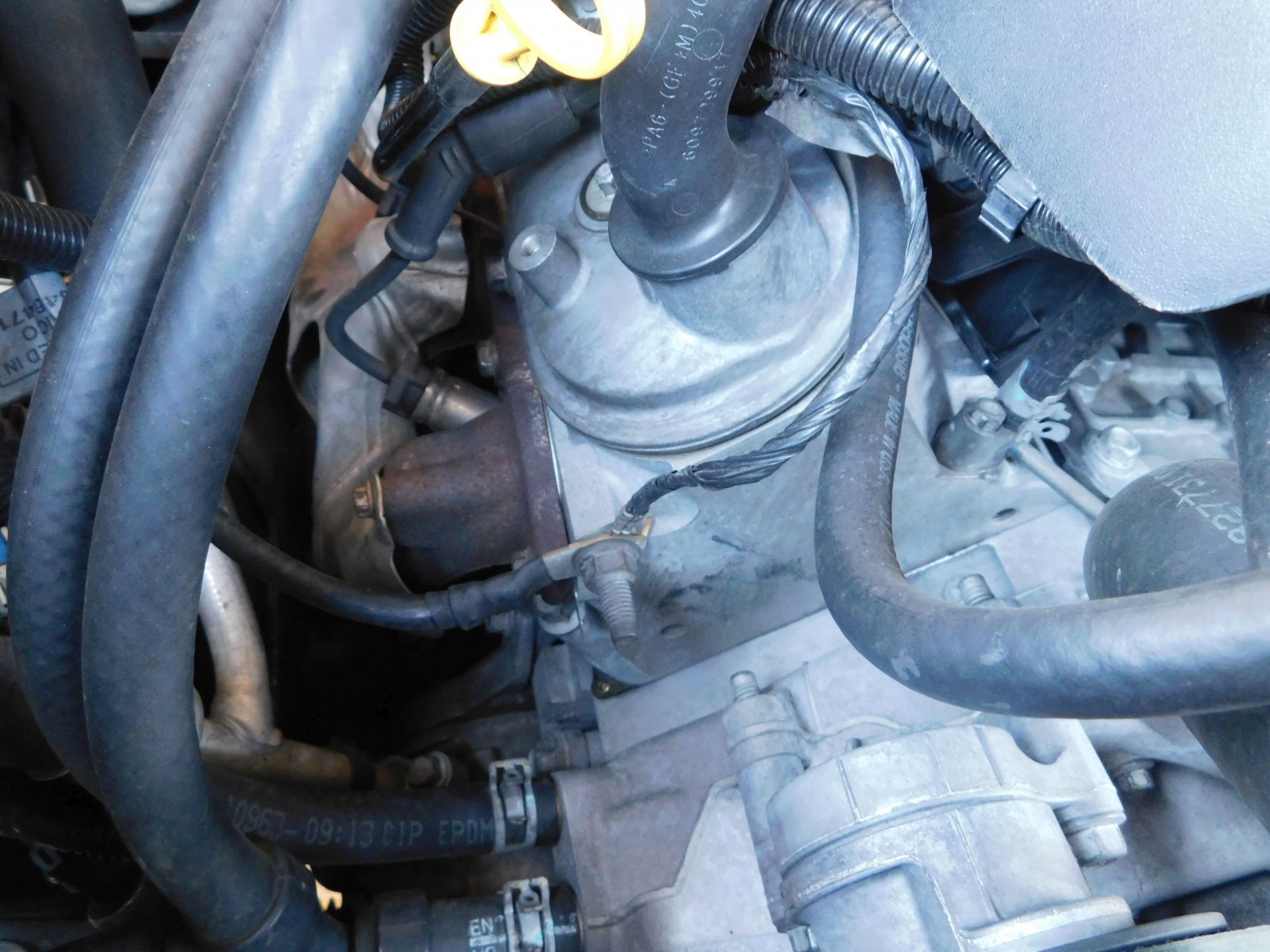

your main battery ground should go here on the passenger side front end of the head, there will be a smaller lead off of the same cable that feeds down to the top of the frame on the passenger side part way up under the radiator support.
I personally also added a large ground from the alternator bracket to the frame on the drivers side
Mine didn't come with that small ground on the head where the battery ground goes to. I'll try to add one to the alternator bracket.
it's not small the oem ground cable is 4 gauge I believe, the little other wire going the opposing direction is the injector ground I believe, could be wrong.
the one I added to the alternator is 0 gauge
then there is the not pictured lead that goes down along the frame to the front.
on the gmt800's it's all reversed to drivers side and the small frame ground you can reach from under the front bumper
Yeah I was referring to the little one... 2008 doesn't have that.
