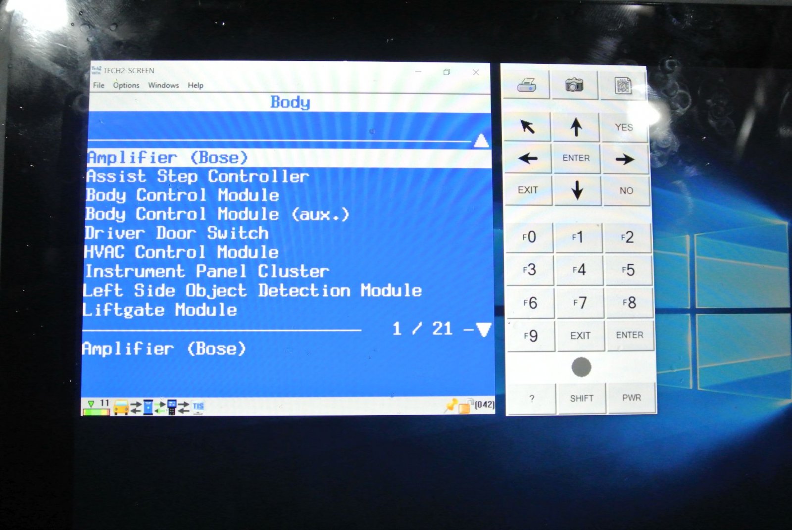

this is where the tech2 will come in handy, if you suspect the ecm you can check the ecm with the tech2, you can check the status of practically any electronic part or you can command it to do what is it designed to do and verify functionality, if the cost of a tech2 is prohibitive then if you have a windows laptop or tablet you can get the vxdiag for $100 instead, it will run tech2 win, which is a software based tech2 and as a plus it does GDS also, best of both worlds.
