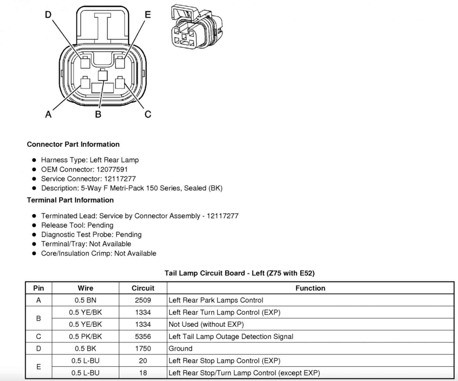

Here's the connector diagram for the driver side.

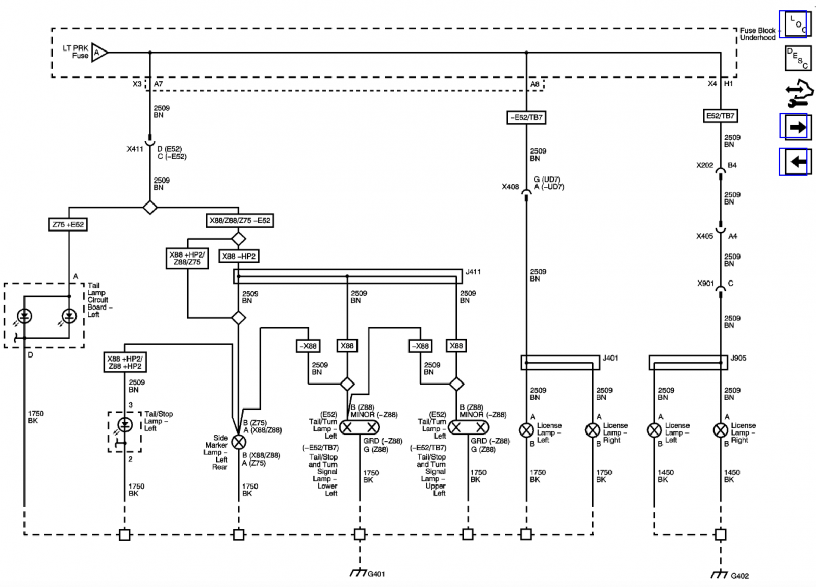

And the wiring schematic for the left side parking lights:
Park, License, and/or Tail Lamps Malfunction
  1. Ignition OFF, disconnect the park lamp relay.
  2. Ignition ON, verify that a test lamp does not illuminate between the control circuit terminal 87 and ground.
¤If the test lamp illuminates, test the control circuit for a short to voltage.
  1. Verify that a test lamp illuminates between the B+ circuit terminal 86 and ground.
¤If the test lamp does not illuminate, test the B+ circuit for a short to ground or an open/high resistance. If the circuit tests normal and the B+ circuit fuse is open, test the control circuit terminal 87 for a short to ground. If the circuit tests normal, test or replace the park lamp relay.
  1. Verify that a test lamp illuminates between the B+ circuit terminal 30 and ground.
¤If the test lamp does not illuminate, test the B+ circuit for an open/high resistance.
  1. Disconnect the harness connector at the appropriate park/license/marker lamp.
  2. Ignition OFF, exterior lamps OFF, test for less than 5 ohm between the appropriate ground circuit terminal listed below and ground.
  • Park/Turn Signal Lamp - Left or Right front terminal C - with X88
  • Park/Turn Signal Lamp - Left or Right front terminal G - with Z88
  • Marker Lamp - Left or Right front terminal A - with Z75
  • Marker Lamp - Left or Right front terminal B - with Z88 or X88
  • Park Lamp - Left or Right front terminal B - Z75
  • Tail/Stop and Turn Signal Lamp - Lower Left or Right rear terminal G - w/o X88 - E52
  • Tail/Stop and Turn Signal Lamp - Upper Left or Right rear terminal GND - with X88 - E52
  • Tail/Turn Signal Lamp - Left or Right terminal G - w/o X88 + E52
  • Tail/Turn Signal Lamp - Left or Right terminal GND - with X88 + E52
  • Tail/Stop Lamp - Left or Right Rear terminal G - w/o X88 + E52
  • Tail/Stop Lamp - Left or Right Rear terminal GND - w/o X88 + E52
  • Marker Lamp - Left or Right Rear terminal B - with Z88
  • Marker Lamp - Left or Right Rear terminal A - with Z75 or X88 - E52
  • Tail Lamp Circuit Board - Left or Right Rear terminal D - with Z75 + E52
  • License lamp terminal B
¤If greater than the specified range, test the ground circuit for an open/high resistance.
  1. Connect the harness connector at the park/license/marker lamp.
  2. Connect a 15 A fused jumper wire between the B+ circuit terminal 30 and the control circuit terminal 87. Verify the park/marker lamps illuminate.
¤If the park/marker lamps do not illuminate, test the control circuit for an open/high resistance. If the circuit tests normal, replace the inoperative park/license/marker lamp.
  1. Connect a test lamp between the control circuit terminal 85 and B+ circuit terminal 86.
  2. Command the Parking Lamps ON and OFF with a scan tool. The test lamp should turn ON and OFF when changing between the commanded states.
¤If the test lamp is always ON, test the control circuit for a short to ground. If the circuit tests normal, replace the BCM.
¤If the test lamp is always OFF, test the control circuit for a short to voltage or an open/high resistance. If the circuit tests normal, replace the BCM.
  1. If all circuits test normal, test or replace the park lamp relay.
