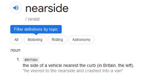

I am assuming you are talking about the driver's side when you say "nearside"? Do you mean inside at the front or rear area? Front area could be driver's side of the radiator or radiator hose. Have you pressure tested to get it to leak faster and do a sight check? Many areas around the engine area can leak and drain down and drop to the ground away from where the actual leak is at.
I honestly, in all my years in this industry, never heard the nearside as a description of a side of vehicle. Drivers side=left side and passenger side=right side.

I hadn't, either, but I've never been to England.
And I've never been to Spain, whatever that has to do with this. I HAVE tried to sleep through a 3 dog night, though. LOL
