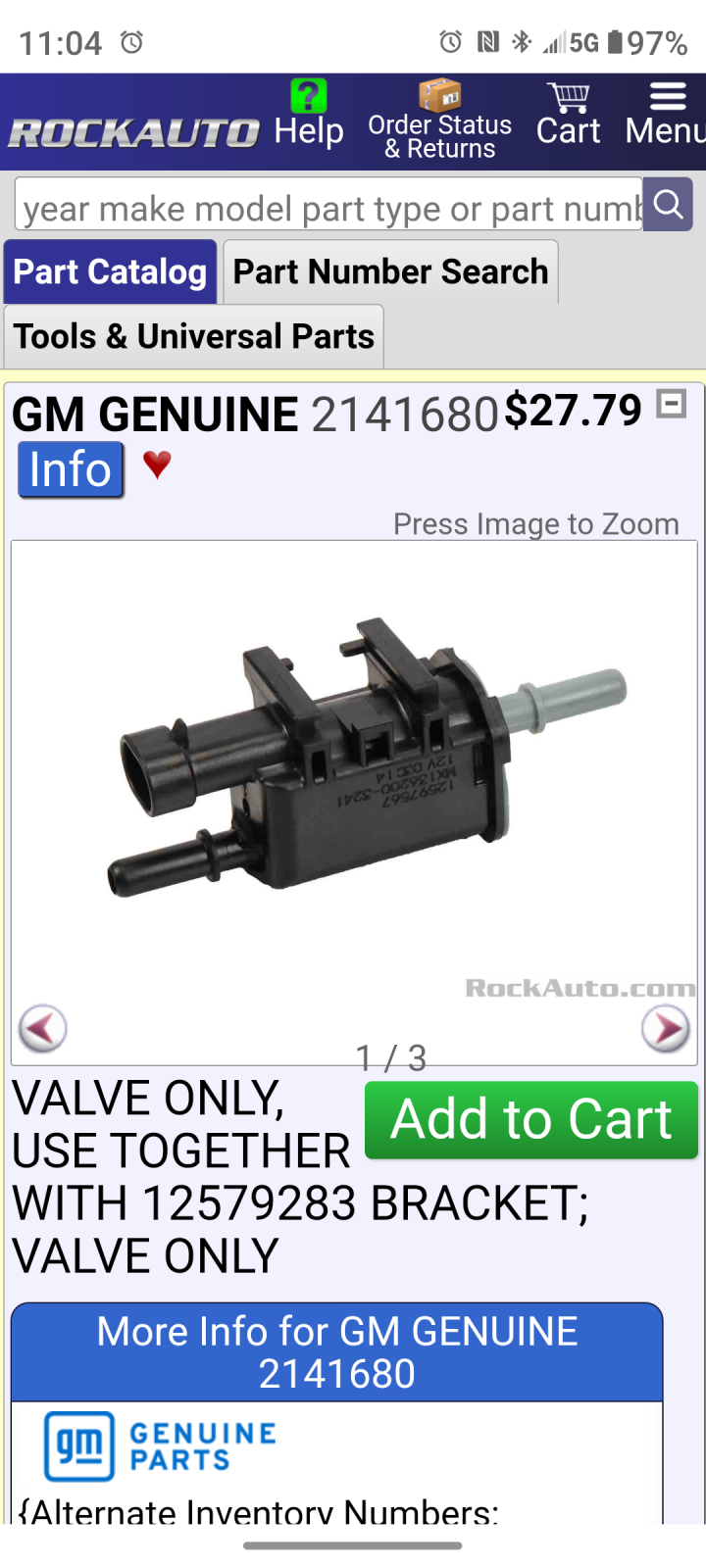

Sounds to me like your vapor Purge solenoid. It literally takes just a couple minutes to change it. If it's stuck open, it's getting flooded with fuel vapors from the carbon canister. Pretty common issue.
Below is a picture of it and the part number. You'll see it on the driver side of your intake manifold alongside the fuel rail.
OK, i have the part and I have located the old one in the vehicle, but I can’t figure out how to get it off of the metal clip. Can you help?
Never mind, got it! Unfortunately, we won’t know whether it works until we are pulling the camper and it’s 90° and we need to get gas. But at least I know it’s done now, thanks!
