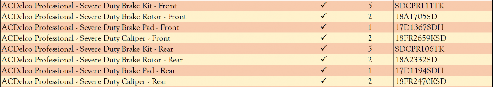

After much research, it is my opinion that the only thing better than GM OE is the Severe Service kits that ACDelco came out with for towing. We are installing these, front and rear on the 2012 Sierra and will report on their performance in the coming months.
ACDelco Professional Towing Severe Duty Brake Parts (1)_Page_1.jpgACDelco Professional Towing Severe Duty Brake Parts (1)_Page_2.jpg
