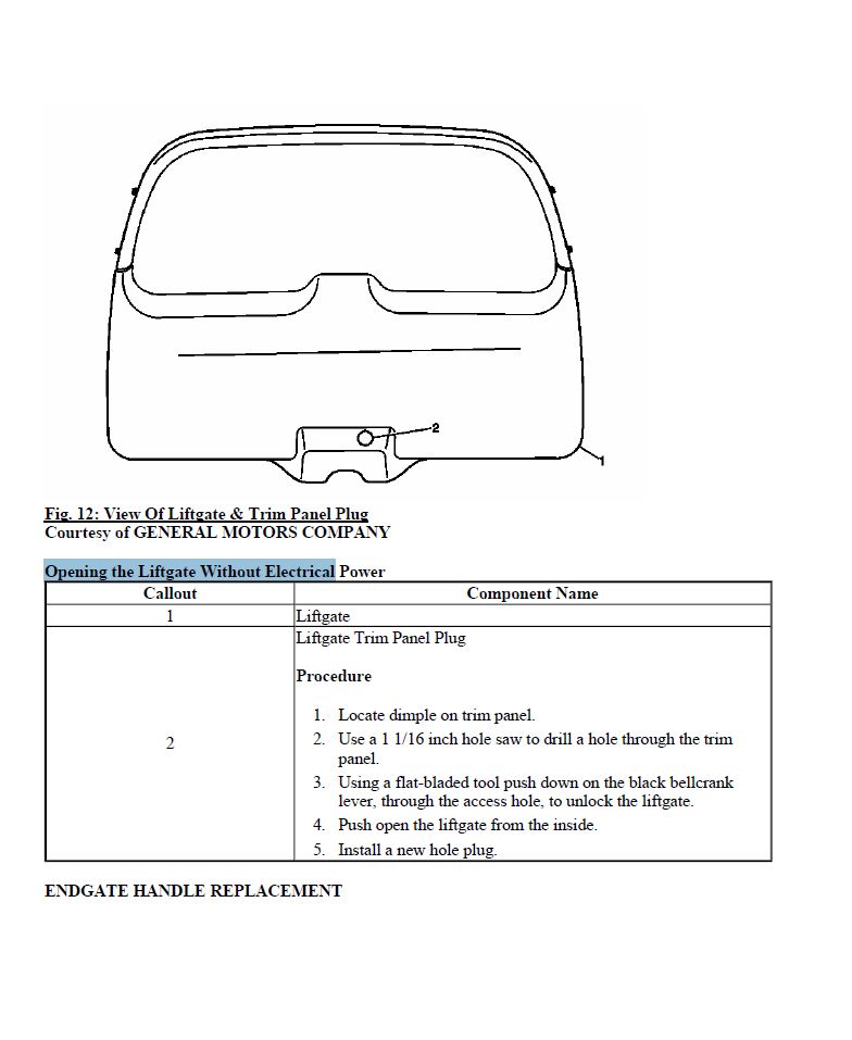

I don't recall how to diagnose and make the repair but on the inside trim, there is a dimple in the plastic that you put a 1-1/16 hole saw against and drill through to access the latch mechanism so you can manually open it with a flat blade screwdriver. GM made a plug for it that ebay sellers are mighty proud of usually.
